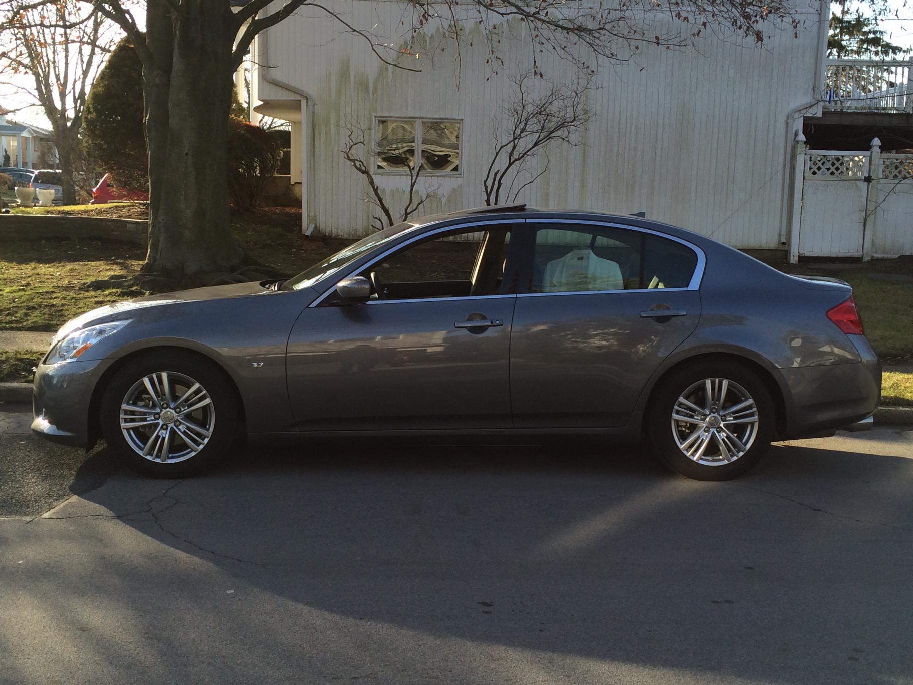

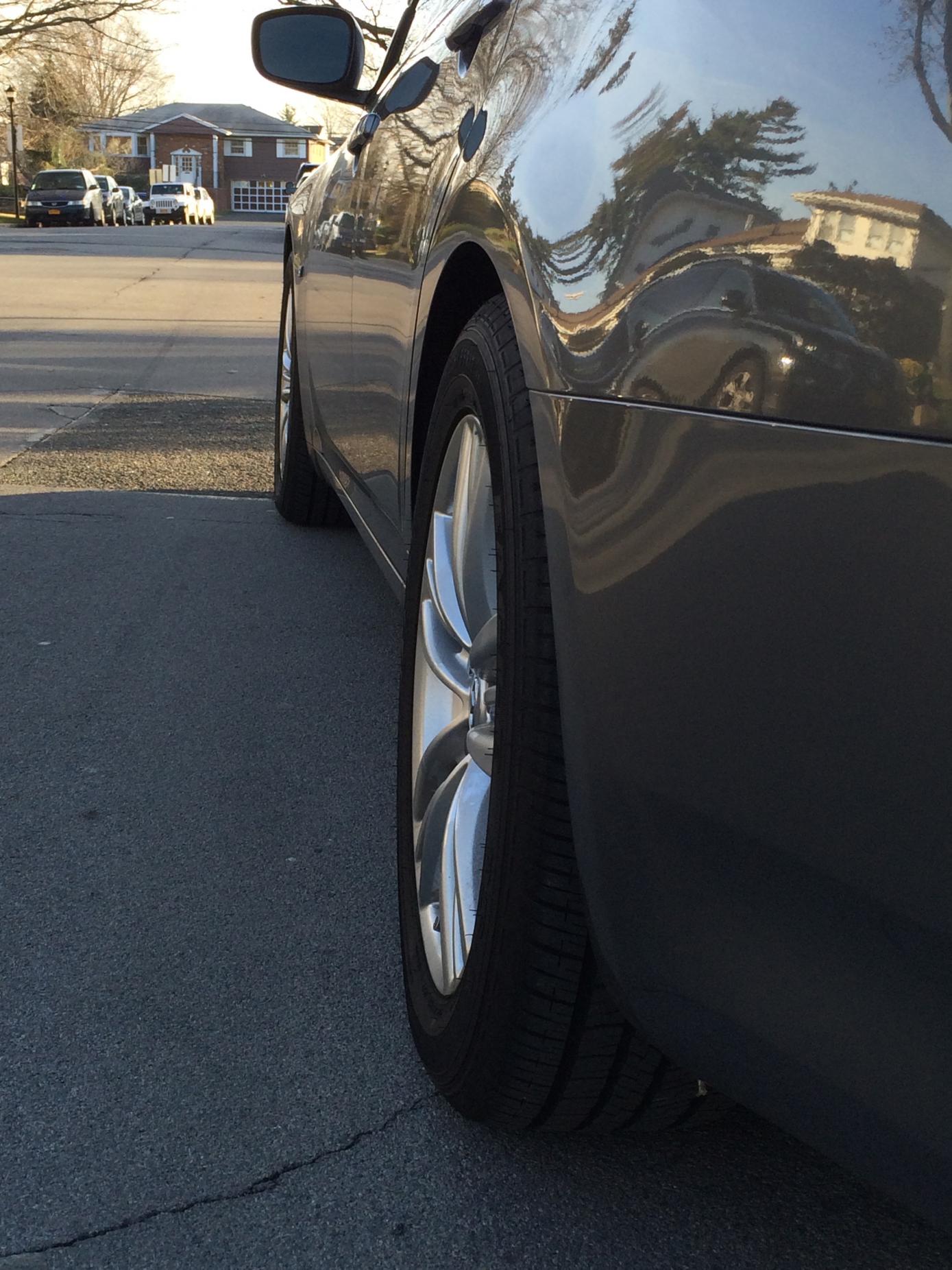

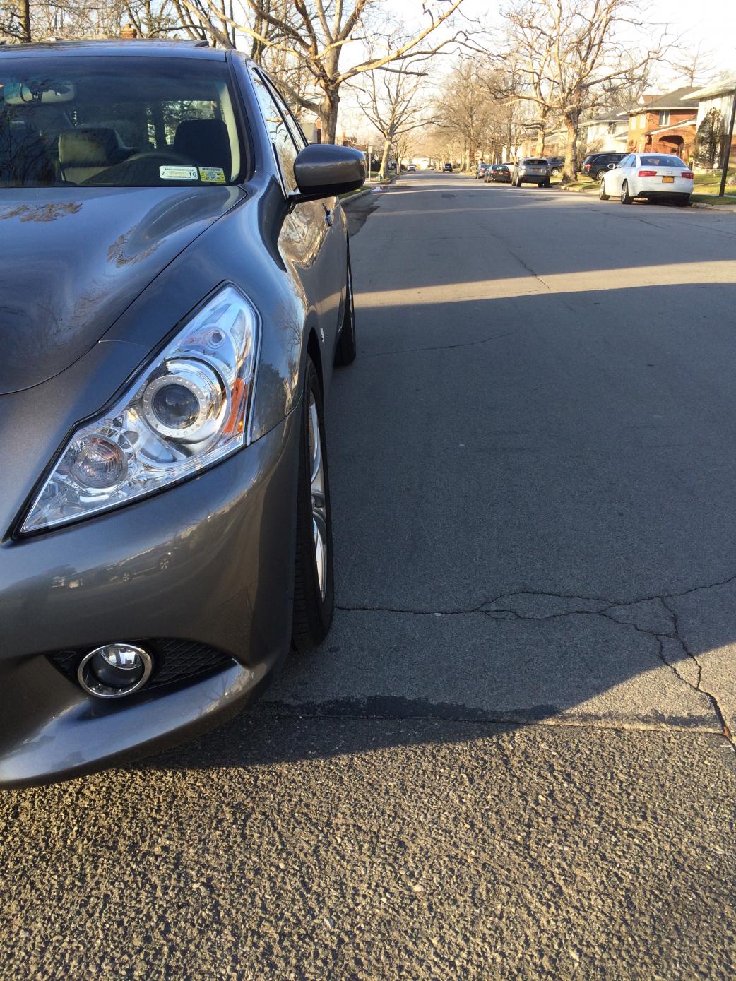

Originally Posted by txg37x
I just got my G37x sedan lowered on swifts for a small drop and now the wheel tuck looks significant. From what I've found on the forum, there are several options for spacer sizes on OEM rims. I was hoping people would post some pics with the spacers and swift spring drop on AWD.
I'm thinking either,
15mm on all four
20mm front and 15mm rear
20mm all around
25 front and 20 rear
I have M45 19x8" rims with 47 offset; running 245/45/19 square setup. Was thinking H&R DRM spacers.
Please post with pics and/or suggestions!
I also just lowered my X Sedan on swift springs. I used 20mm H&R spacers all around
Attached Thumbnails Spacers for G37x Sdn w/swifts: What sizes are you running on OEM rims? Pics?-img_4792.jpg   Spacers for G37x Sdn w/swifts: What sizes are you running on OEM rims? Pics?-img_4818.jpg   Spacers for G37x Sdn w/swifts: What sizes are you running on OEM rims? Pics?-img_4822.jpg

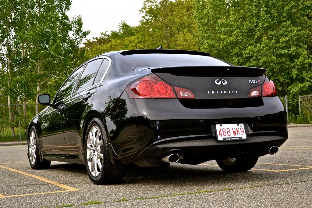

"a picture is worth..."

Draigon has lots and lots of pictures that prove (to me, at least) that on the G37xS, the AWD Swift Springs and 20mm spacers on 18x7.5" (square) duckfeeet are a perfect setup for people who like the OEM look, but vastly better fitment. For the RWD, staggered cars, it gets a little more complicated. And more so with aftermarket rims.
But for a known quantity, Draigon nailed it.
Thanks John!
They're not too bad on 18x8" aftermarket wheels either

Dragion's picture show it off well, should aid in your decision.
