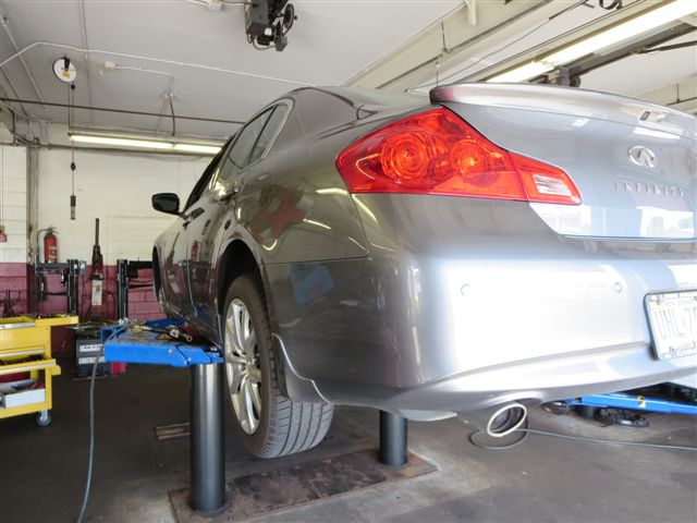

I wish it did but it saved by butt while driving home from work last week at about 70MPH
I heard an auduble blip with a warning light and a lit TPMS on the dash.
Fortunately I carry a tire pressure gauge and pulled over to check the tires.
The drivers side front only had 20 lbs of air. Drove to the nearest gas station and filled the tire with 50lbs.
Made it home to a local tire repair where the pulled this out

Some people ignore the TPMS light but it sure saved my a$s
Glad I didn't have to change a tire.
