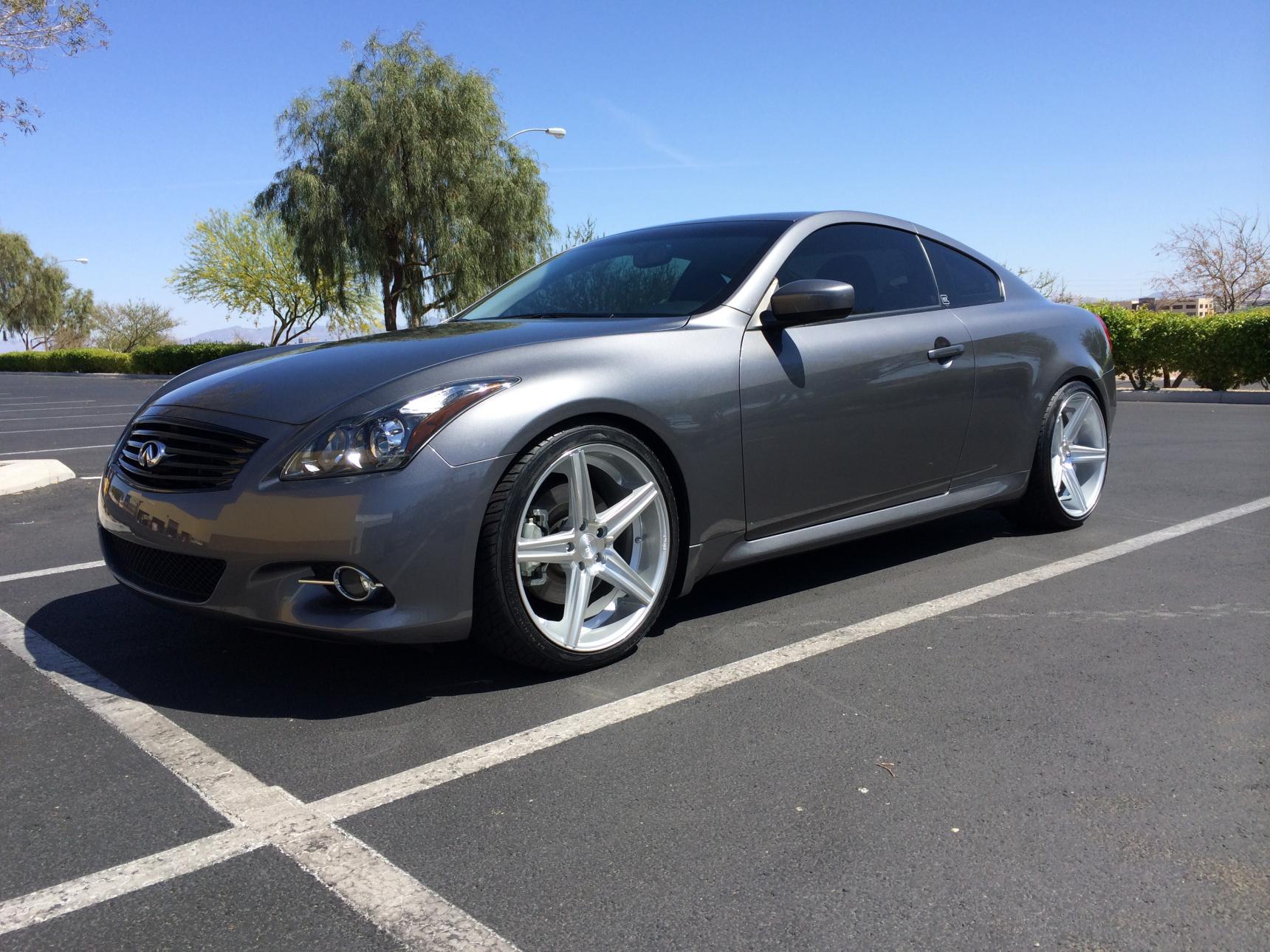

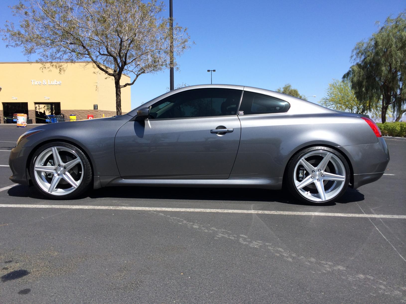

Here's a couple shots of Niche Apex wheels on Vic555's coupe
