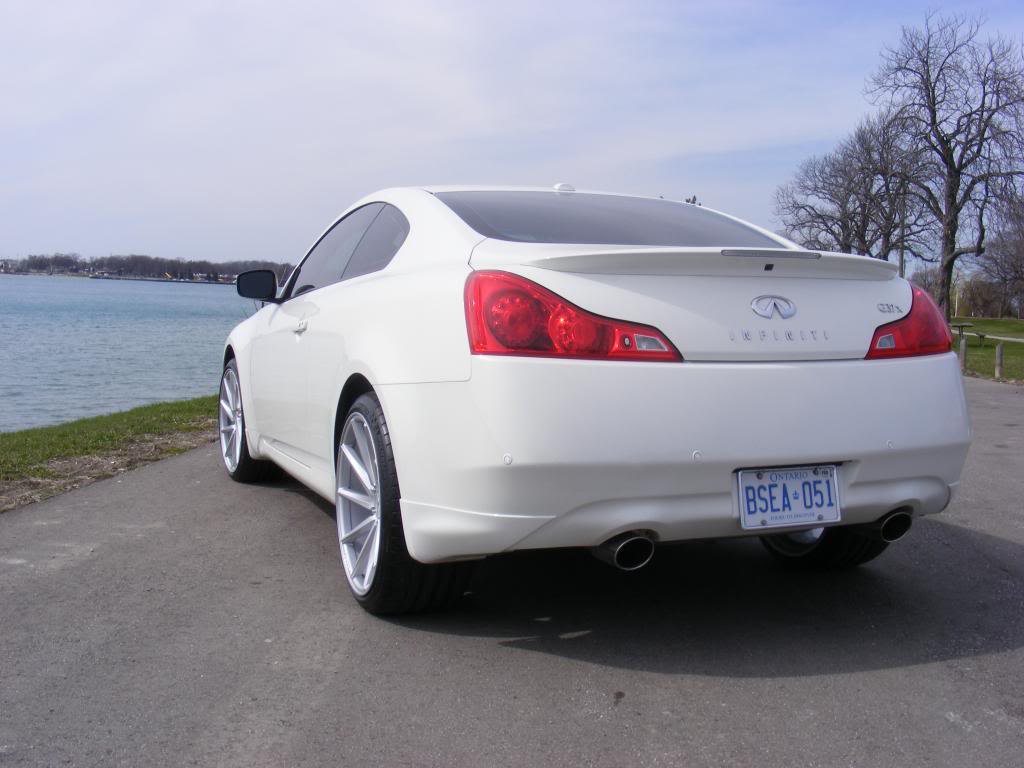

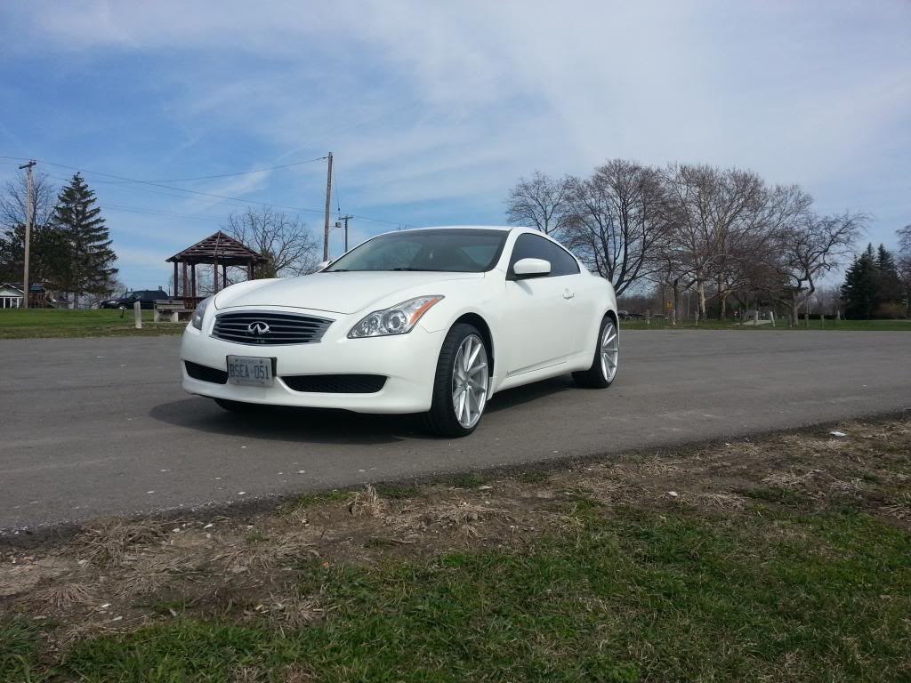

i have a white 2010 x coupe as well, i got the vossen cvt's last month... i went with a staggered setup, because i love the deep concave in the back. There was no issues at all with installing these in the x coupe. fronts are 20x9 with a 245/35/20 tire, backs are 20x10.5 with a 285/30/20 tire, i put on michelin pilot super sports. I have upsized the wheels on all my vehicles, and they all act the same after you do, they will follow tracks in the road more, the handling sharpens up alot, and you get alot more feedback from the road.
