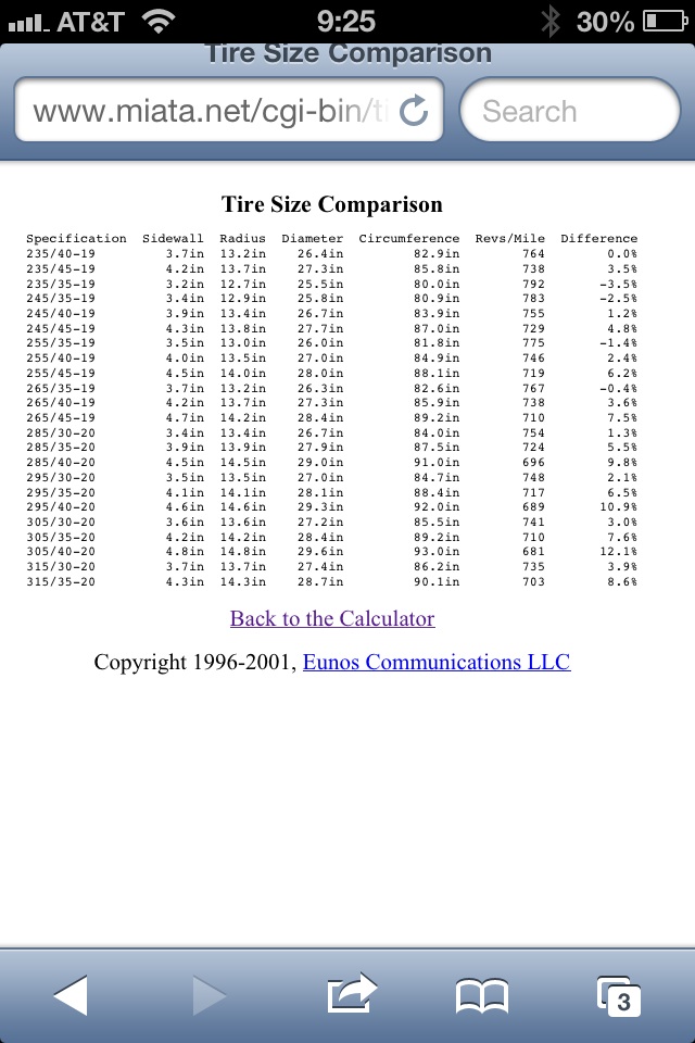

There'd be zero issue as long as the tires are same height (within 0.3"). Don't know while everything thinks wheels matter. That's not whats rolling you down the road and doing the revs per miles.
Only thing I'd worry about is offset and width. A 10.5" rear might not look good with a low offset since the G doesn't have wide fenders like a Z has.
You'll need a 235-265 front tire and a 285-320 rear tire for those widths.
Here pick two within 0.3"
