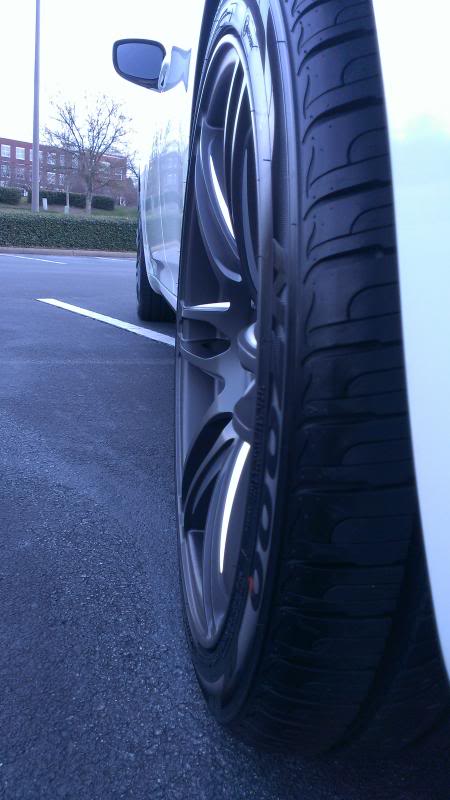

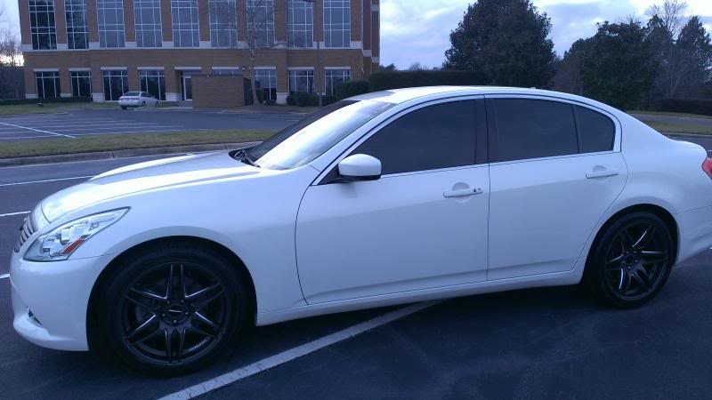

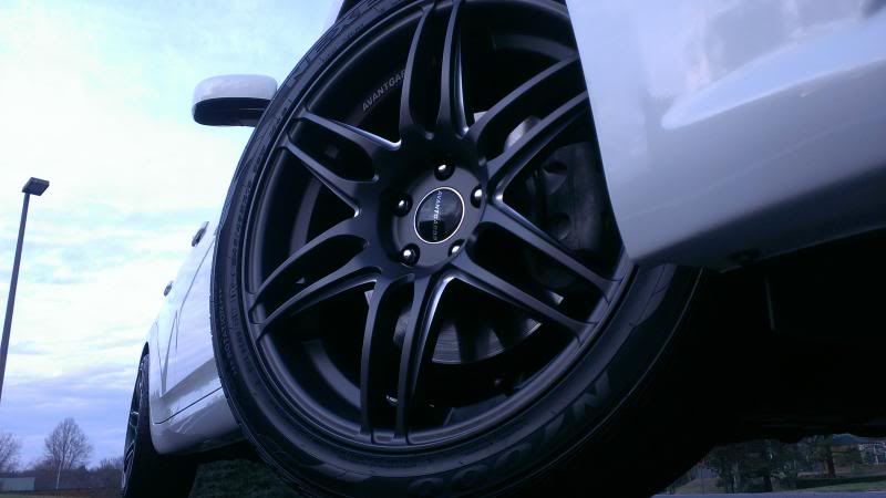

Heres my setup, Avant Garde M368 19x8.5 +35, 19x9.5 +40 245/40 275/35 Nexen. Still need to drop, I plan on the eibach pro plus kit with coils and sways.

Bet you're happy w/ those, great look (I've always eyed those wheels and almost pulled the trigger but didn't have sedan offsets in 20s at the time). looks like a great fit too! Be awesome w/ a drop!

^^^^^ Yea, blnewt nailed it. Those wheels look good. I considered those at one time also. Love the contrast with your G.

Paratrooper, your rears are flush or just a tad bit tucked? Hard to tell from the photos. I've been contemplating these as well since Blnewt recommended them to me. How are they so far?

The rear is pretty flush, basically if I slammed it I would need some negative camber..but we are not talking too much poke, by no means.
This setup is very comfortable driving, hard to tell I'm running aftermarket rims based on the drivability. I think this is mostly from the weight- 26lbs fr, 28lbs rear. Roughly.

Actually when you lower it they'll tuck in and w/ rear camber arms you'll be able to get the camber back in spec w/ no poke

That's good to know, maybe with eibach it won't be too much tuck, fingers crossed on a decent alignment spec without needing the adjust arms.

My offsets are 9" +32 and 10" +38 and I'm clear. You'll be fine after your drop. I'm on Swift springs which are a similar drop to Eibach. Alignment showed I was within spec so I didn't get a camber kit.
