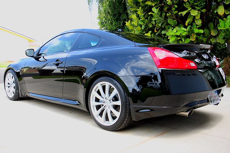

Here is my G with 20mm front / 15mm back...Im really thinking about replacing the back with 20mm.
If you go with 25mm in the front the rim will stick out too far.
With the 20mm you can see the lip of the rim if you look down from the top of the edge of the fender.

Yeah, your rear looks like it could use a little more compared to the front. Gio, are you running stock tire sizes or 245/275?
I looked to confirm:
F = 225/45
R = 245/40
Yeup, my concern was rubbing so I went with the 15mm but after the install I noticed I could of gone with 20mm for the rear.
