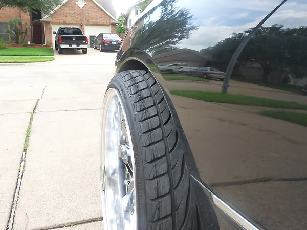

Slightly outside the fender? lol Name:  P1020309.jpg
I'd go with the larger spacer in the rear, or keep them both the same size. I definitely wouldn't put a wider spacer in the front like your idea of 25mm front and 20mm rear.

I'd recommend your choice is better made between 15mm and 20mm... not 25mm. "Slightly outside the fender" is no bueno.

I def. don't want them like Ryne's picture.

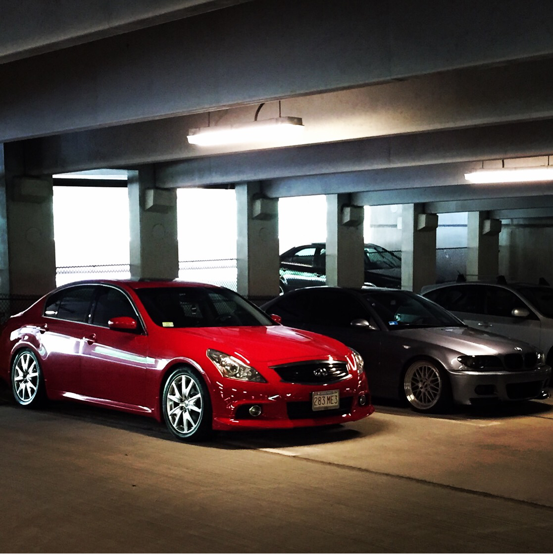

You are correct OP, the fronts sit in further on the X with the duck feet. I went with 25mm up front and 20mm in back which will get you pretty flush and very even spacing from front compared to back. I was dropped on Swifts though, without a drop they might be poking a bit, but if you have any kind of drop, I 100% recommend that set up. Makes the duck feet look their best!
I am dropped on swifts just like you.
You wouldn't have any photos you could upload here?

Theres a pic with the duckfeet, spacers, and Swift drop. Thats really the only pic i have though, unfortunately i dont have and close ups of the fitment but the fitment was pretty tight, no rubbing though
Attached Thumbnails Spacer size - info/recommendation needed-photo843.jpg
