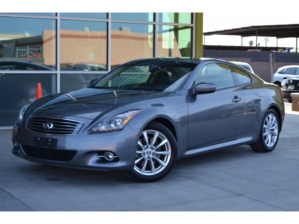

If you have the traditional journey 18" wheels as seen below.. 10mm spacers up front will clear Akebono's. I know from first hand experience as I run these wheels with Michelin X-ice3's in the winter. (10mm H&R's on extended lug bolts). It is within a millimeter or 2 of clearance, if that..but it clears. Problem free all last winter.
I run 20mm in the back, but not for clearance sake (not sure if they're even needed, I don't believe so), just to keep from looking sunken in throughout the winter and with the fronts pushed out already. I am lowered on Swift and Koni's, thus the sunken in look on stock offsets is a greater aesthetic offense that had to be addressed along w/ the clearance up front.
Disclaimer, not my car below....
Attached Thumbnails What spacers will I need for 18" wheels on 2009 X Coupe with Akebono upgrade?-1440032761404551-large.jpg
