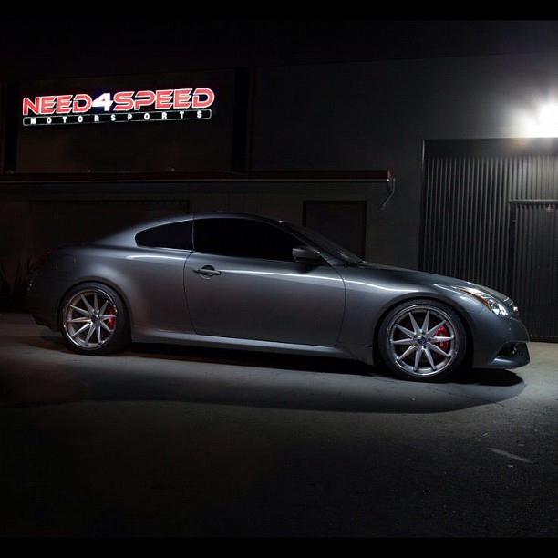

Do the 20x10+40 up front and add a 10mm spacer.
Rear do 20x11+28. The grey G37 on their website is my car. My old set up.
Tire sizes should bee 255/35/20 front and 275/30/20

The car is completely stock, will the wheel gap be too much?
Also, where did you get them? Did you get a wheel and tire package? Thanks

If you don't plan on lowering your G the gap w/ 20s is pretty glaring.

As for going Rohanna... nice wheel but if your staying stock suspension I'd stay in the 10 in width... any thing more than that will have poke! Will look funny... go Eibach if you want a lower but stock look... jmo... 10.5-11 at stock will be pokin...
