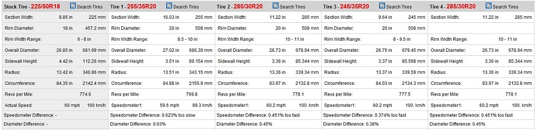

Is it possible to put the OEM wheels back on? Give that a shot and see if the problem stops. If the problem goes away, it's your tire sizes. The ideal sizes to run for staggered 20s are 245/35 285/30 because they are essentially the same diameter. If the problem persists, it's actually an AWD problem.

Old Jul 10, 2012 | 10:36 PM
MaxdOut's Avatar
MaxdOut
Joined: Mar 2009
Posts: 206
FYI he's right...

Keep us posted if you figured it out. I always read its ok as long as you are within 3% of the overall diameter. Looks like you are within 3% of the stock, and front to rear.

So I actually got the new tires on Friday! I thought I was okay too because I was within 3%. But I switched tires and it actually fixed the problem. I did some highway driving for about two hours and didn't see the light come on at all and it use to come on within 10-20min usually on the highway. My tire guy was even super surprised to hear that Infiniti system was that sensitive. He said that he would run different rolling diameter on Mercedes and bmws and their systems never have the same problem.
