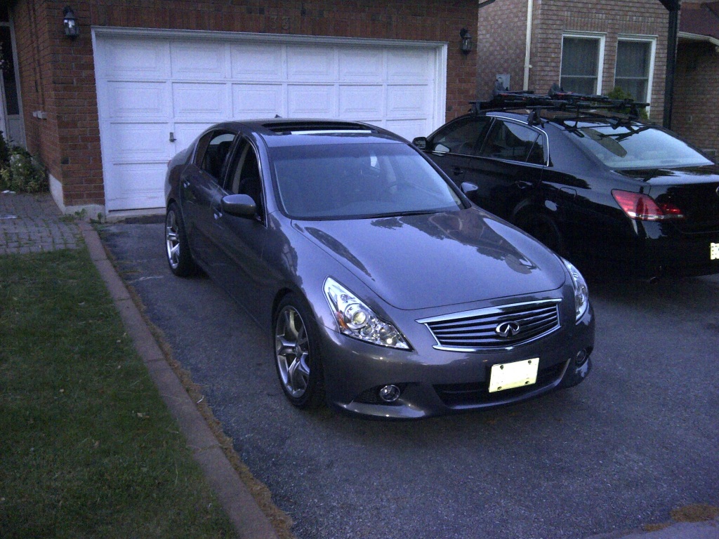

Hi Guys,
I posted a while back about this and had some work done (had the car lowered on Swift Springs and put 20MM adapters in the front.
However , I am experiencing some pretty unpleasant vibrations at around 100km and over.
What is the solution here because I really love the flush look on the fronts but feel like these vibrations take away from my feeling of safety and performance of the car. Not to mention to vibrations intensify as I go past 100km/h.
Any thoughts or help would be much appreciated.

^^^ exactly.
Its the spacers. If you don't know what brand they are, I can almost guarentee they're a knock off. Where did you get them?
H&R are the highest rated spacers on the market. Let me know if you'd like some pricing, I can get you good quotes on new, otherwise there's always used in the private classifieds.
OP, Out of curiosity (since you have swift springs), do you have an 'x' sedan or RWD?
And PS, I agree with the above. Your spacers are probably not truly hubcentric, or they are warped. At any rate, I'm not a fan of spacers at all, but that's just my bent towards performance first.

First "ashmostro" there is nothing wrong with spacers if they are of quality construction and are truly designed for the car. H&R and Eibach make quality spacers and I have raced (track school) on 25mm H&R spacers for the rear and 15mm for the front using sticky track tires on my NSX for over 15 years with no problems or vibrations. Second it's really fairly easy to find out where the vibration on this car comes from by just doing simple logic while trouble shooting the problem. Ask your self these questions in this order:
1. Did the car ride fine and without vibrations of any type while stock?
2. If yes, then what changes have you made to the car?
3. It sounds like you added new springs, and spacers. See #6 next before proceeding.
4. Remove the spacers. Does it still vibrate. Yes, your springs are probably overwhelming the shocks valving capabilities. Get better shocks or different springs.
5. If no, then it's probably your spacers. Take the spacers off and see what happens with the stock mounting point. Make sure your lug nuts are torqued to 81 lbs. and do this by hand with the proper tool. If you don't have a torque wrench get one. A half way decent one should cost no more than $30 or so. Sears has a ton of them.
If the problem goes away with the spacers off, then find a better quality spacer. Don't go with any spacer large than 15mm or greater on this car. You may not be engaging enough threads on your lug nuts to hold the wheel on properly with a large spacer and this causes the wheel to feel tight when torqued on the ground but once moving, the road vibration causes enough flex to the lug nut bolts to loosen dynamically. The wheel then is actually moving or vibrating while on the spacer/hub setup and you are now in a dangerous territory. There are spacers that can solve that problem which are 15mm or larger but they cost more and are have their own lugs on the spacer to bolt the wheel on.
Also remember that the spacers are changing the stress on the suspension components due to the extra length they create on the outside of the rims normal mounting point. This extra length will accentuate the action on the suspension components of any road irregularities such as a pothole. This may be just enough to overwork a shocks valving for what the car may have been designed to handle and give you the feeling of a less secure road feel.
6. Check to see that you haven't thrown a wheel weight or that one wasn't accidentally knocked off when the car was worked on. It wouldn't be the first time I've seen that happen.
I've had a similar problem like this when I bought different rims for my NSX which I just couldn't figure out. It ended up being the custom spacers they made for the rim which were not hub centric and moved while I was driving even though I had torqued the rims to specs.
Eventually I lost 3 lugs on the right rear and two on the left rear while traveling on the twisty Highway 1 on the California coast. Had I lost a wheel while driving we would have gone over a cliff into the ocean below.
Damn lucky.
Your problem is probably minor but find out what it is so you can then trust the car again.
Al
Damn lucky.Your problem is probably minor but find out what it is so you can then trust the car again.
Al
