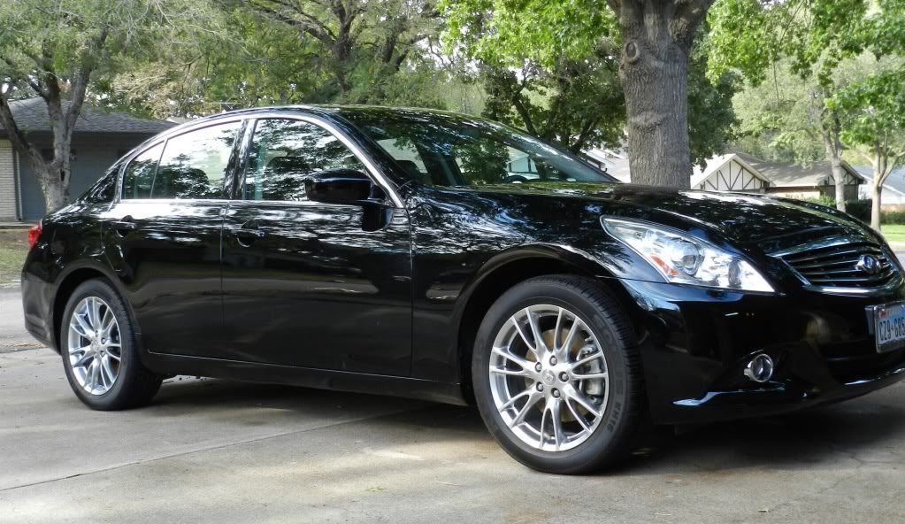

Originally Posted by G37Sam
The Sedan's OEM 18's are not the best looking wheels IMO
Really, you think these are not very good looking?

IMO 19s or 20s will give you better performance (all things being equal) due to the stiffer sidewalls, now ride is definitely firm, but I love it that way.
I'd jump on those coupe wheels, you should be able to find some in your budget. Those ugly 17&18" wheels on the current G sedans really take away from an otherwise beautiful car IMO.
Yeah, these are so ugly...

Those aren't the ones on the 2010 MY but I agree they aren't the most attractive...
