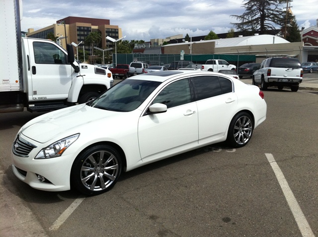

from what I know the car would only pull from the alignment, Theres plenty of member here running the sport 19s with no issues. post a pic, Im curious to see how it looks with those tires

Also here's a pic

Here is a white sedan with the rims. They are the 25th anniv. ones.
