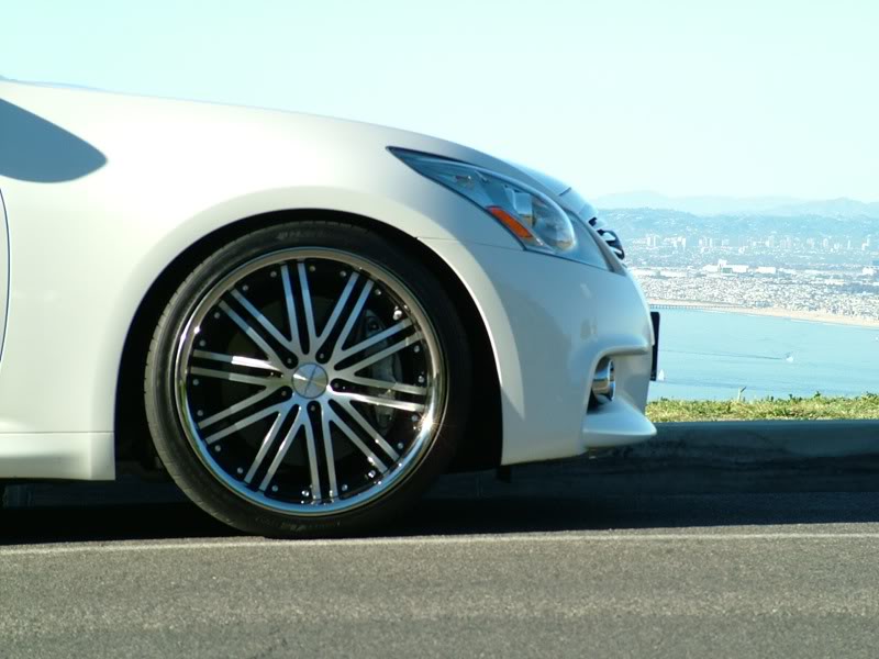

Here are my specs:
Vossen VVS 082 Black Machined
20x9 front & 20x10.5 rear Offsets +32/39
Hankook Ventus V12 245/35/20 285/30/20
No issues with fit at all! Lowered on coil overs.
