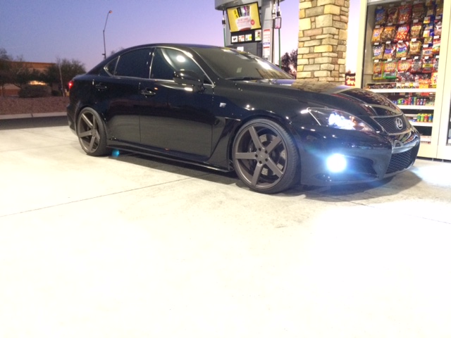

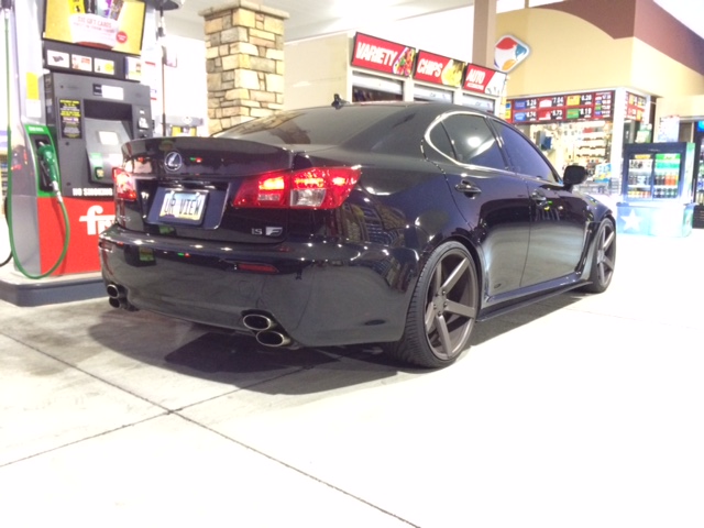

I bought IvoidWarranties old G37 coupe last week for my wife and I'm looking to throw some Vossens on it. I am dropped on eibach springs. I'm looking to get some CVT's, and want a nice aggressive setup without rubbing (meaning top of wheels to be flush/ or very slight poke with the outside of my fenders) and only plan to run natural camber with no fender mods.
Anyone know the exact specs for wheels size and tire sizes in 19" AND 20"? I am debating which size to use. Pics would be very much appreciated! Here's a couple pics of my ISF on Vossens

Originally Posted by RedlineAZ
Can someone here help a brotha out?!
We recommend 20x9/20x10.5 +32/45 with our CV line and VF Series aka flow formed. With VFS1 we now have 20x9.5 +25 which is a mid-face concave and can be ran with 245/35/20 and 285/30/20 with either route you choose.
VFS1/2 also offer 20x9 +32 if you want something more conservative but the 9.5 mid concave is pretty nice and flush.
I previously ran 20x9.5/20x10.5 with 255/30/20 and 305/25/20 and looks damn good.

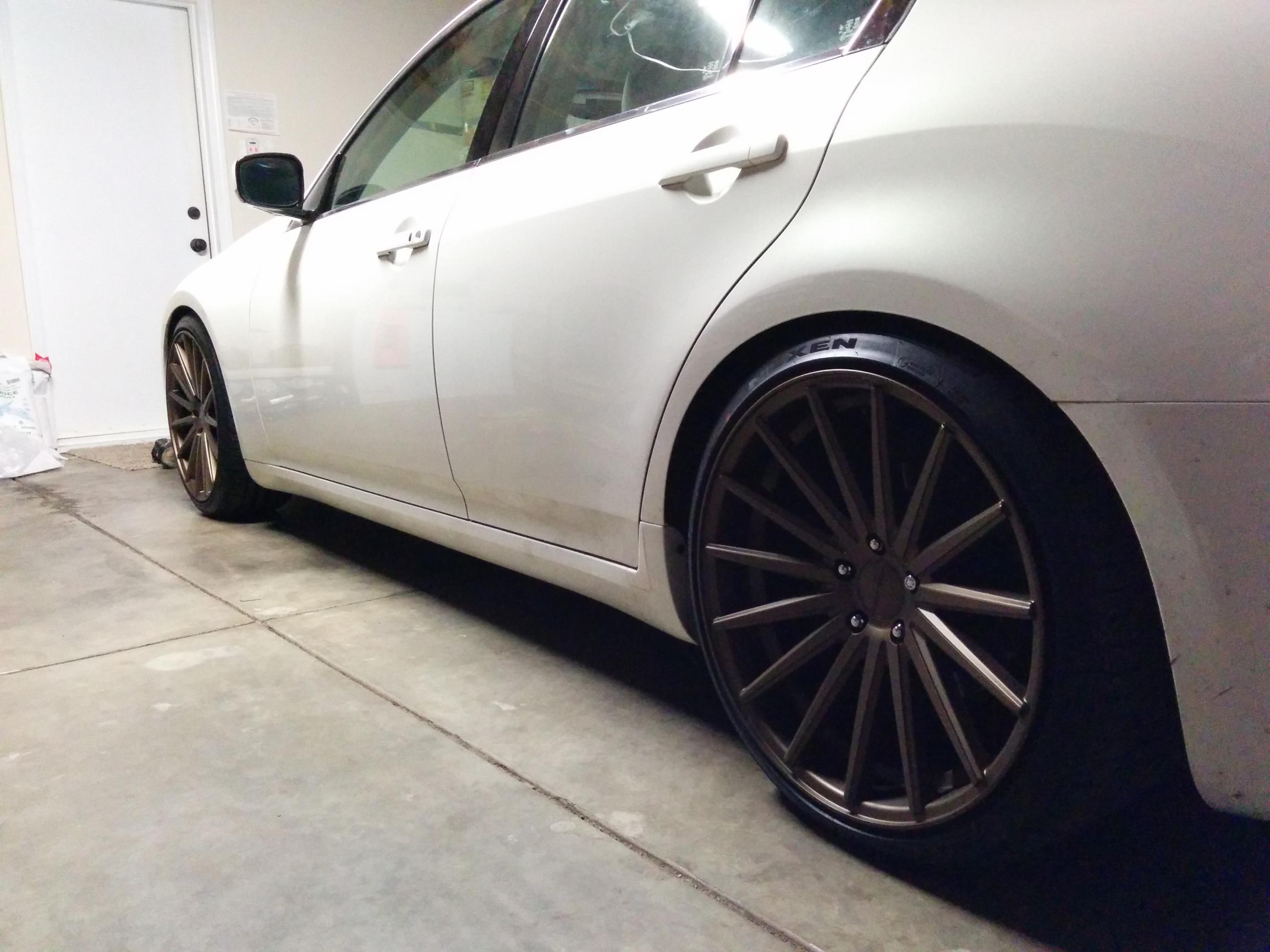

Originally Posted by weedymane
Do I need to roll the fender for Front 245/35/20 rear 285/30/20? +32 vs +45 offset is the different in how deep the concave is or how far the wheel stick out?
thanks in advanced!
Here's my sedan. Lowered on Tein S-Tech with front and rear camber kit. Almost the same wheel set up as stated except 275/30/20 in the rear. Almost flush with no fender roll.
