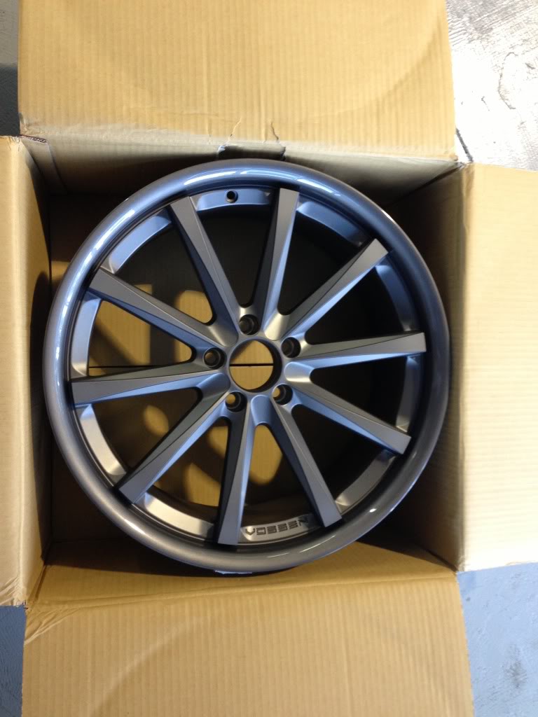

These bad boys just came in today, can't wait to mount them!!

^^lets see how long u wanna keep these lol

Good choice man! Can't wait to see your ride with these on it!

Sik wheels, when is the mounting going down?

Lol buddy I love these. Only wheel now that can take me away would be a gunmetal vps wheel and so far I still like these better than any new designs I've seen :0

Very sweet wheels, i am tempted to try them before the VPS but may hold off. Post pics when mounted

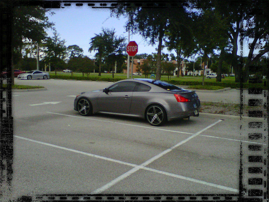

Here is Eibach Springs and VVS-CV5s 20x10.5 | +25/25 | Dunlop 265/30/20s on all 4 corners.
