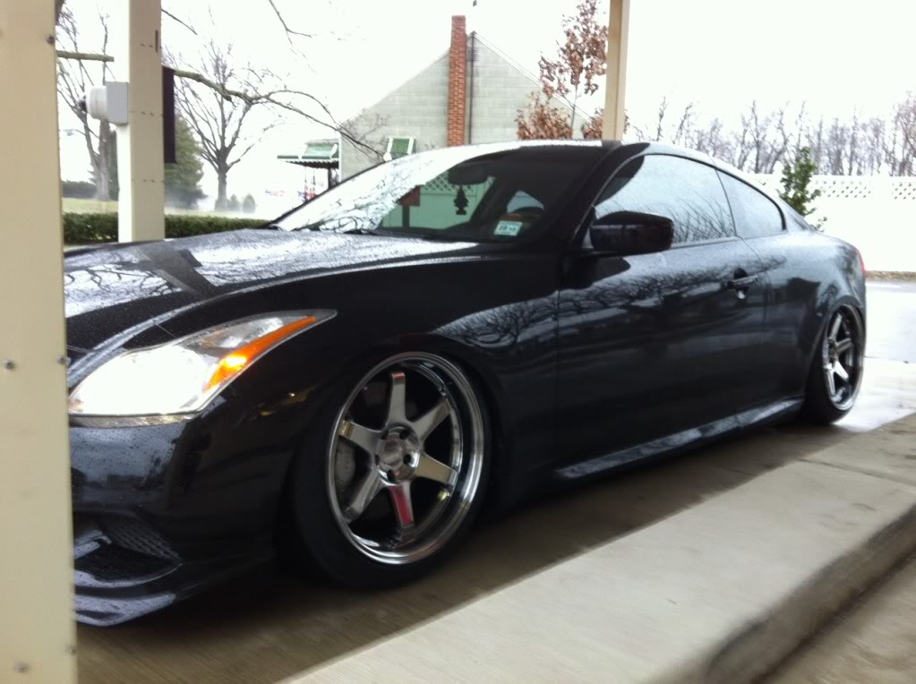

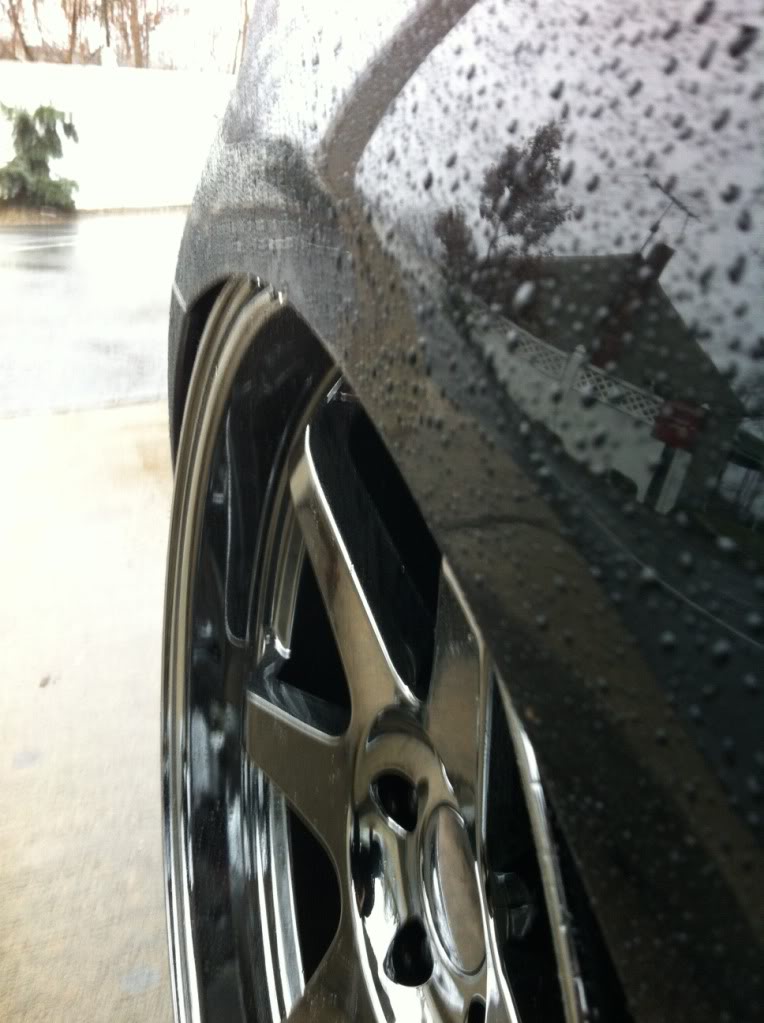

Old Dec 27, 2011 | 03:50 PM
  #1091
fairladyz34's Avatar
fairladyz34
Joined: Oct 2010
Posts: 1,360
From: Central NJ
Sorry for the crappy pics, rainy day FTL. Anyway heres a pic of my newest set of wheels, slightly less aggessive than my ISS's that were 9.5/10.5 +10. Ill take better pics as soon as the weather is better.
19" Varrstoen 2.2.2
Limited Edition Black Chrome
Front: 9.5" +12 w/ 225/45/19 Hankook V12
Rear: 10.5" +12 w/ 245/40/19 Hankook V12

Old Dec 27, 2011 | 04:12 PM
  #1092
TeRRoRiFiC35's Avatar
TeRRoRiFiC35
Posts: 1,024
From: Jersey Shore....
I'm not in love with the color combo for some reason... Something just is throwing it off for me

Old Dec 28, 2011 | 02:05 AM
  #1094
Doggy's Avatar
Doggy
Joined: Jul 2010
Posts: 4,354
From: Sf valley
Fairlady I like it. What's your camber at driving height and how high is it?
