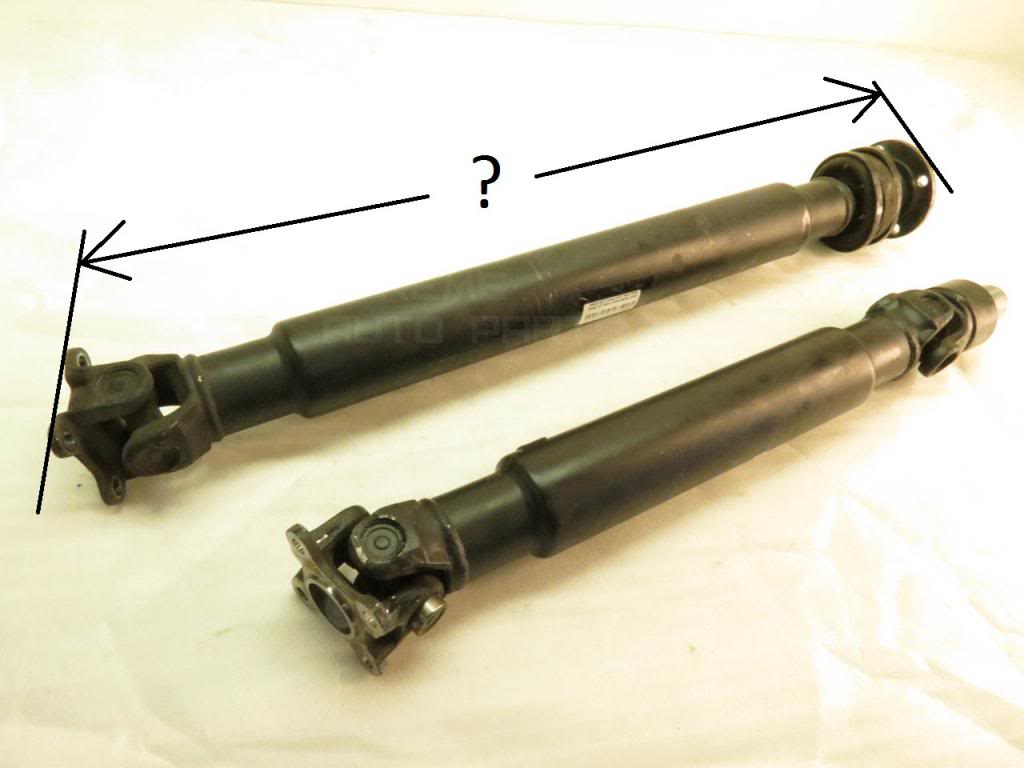

This is an old picture I used a few years ago when I was doing all the research to figure out how to do this mod correctly. This is not my driveshaft but rather one I got off the internet so I could ask some questions. The drive shaft is two pieces. The carrier bearing for the driveshaft is located in the same place on the car for both autos and manuals. The front half of the driveshaft is different in both length and coupling between the manuals and autos. That makes sense, two different transmissions. The rear half of the driveshaft should have been the same but Infiniti used two different rearends (differential housings) for the autos and manuals. The autos have a smaller housing and can not accept the 4.08 gear set. There is a different coupling between the two. The autos uses a tri-flange with a rubber connector and the manuals use four bolt flange with a u-joint.

If your car has the 4 bolt flange or the 6 bolt flange driveshaft you will be able to use diff from all 3 type of diff flange that can be found in the G (3, 4, 6 bolt). You can use a puller to change the flanges between different diff. The only exception is if you have a 3 bolt flange, in which case you'll need a new drive shaft if you want anything besides a 3 bolt flange diff.
THIS WILL NOT WORK FOR AWD!! Your front diff and rear diff have to have the same ratio!
