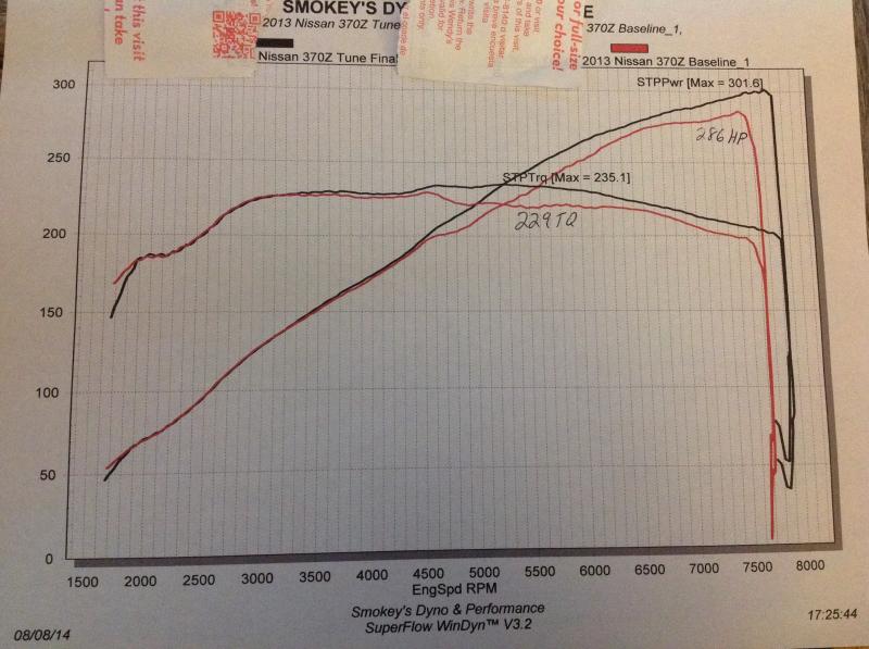

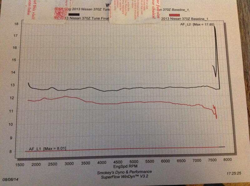

So I finally got tuned today at Smokeys and I believe the 2nd here. Although the old tuner is gone for reasons that aren't good I guess. To my great surprise the car was still rich! It was rich stock I'm sure, rich with a CBE and CAI, rich with a LTH, and rich with ported TB's, ported upper and lower manifold. Average looks to be around 11.6-11.8. That sucks because I was taking it easy for fear of being lean for like 3 weeks after the manifolds and TB were installed.
Now after the tune its running around 12.6-12.7. The tuner said some run into the 13's but we felt safe with it turning into a track car to not make a dyno queen. I was told timing had been picked up around 3-4 degrees and there were some issues with uprev. The data logger was acting up only getting some of the items at times and the 2013 ROM wasn't doing what he wanted it to do. He would tell it to do things and it wouldn't 100%. Pretty much took all day after waiting 2 hours for uprev to email a license and some other things then start to build a new MAF map.
Since the car was rich he did a base run pull with the OEM size MAF housing so we could see a before and after on his dyno. I've never been on this one before and never heard of it. It's called a superflow AWD and uses something called STP instead of SAE or STD. After the base he started turning everything up. We swapped the MAF from 2.5" to 2.75" and finished it up. Results look to be around 15hp and 6tq at max peak with around 15hp and 15tq above 4500rpm in the mid range (minus that base run boost from 6300-7100). Pretty much what I thought a NA tune would do.

So the tuned numbers include just the switch to a 2.75 maf and tuning? Not quite the numbers I was expecting but not bad numbers to say the least. I wonder what the numbers are in std and sae. Thanks for going through with this and posting for the better of our community! Much appreciated!
Correct, tune and just a 5" MAF switch. Have you seen tunes get more than that? I haven't. That's normal increase for some timing and fuel on a NA motor. The point of the post is to show AFR isn't effected by the porting so your safe till tune time. I'll show what the porting did at IPS when I go back. Last was 293hp and 243tq. We know the tune got 15 so whatever's over 308hp and 249tq is all the porting.

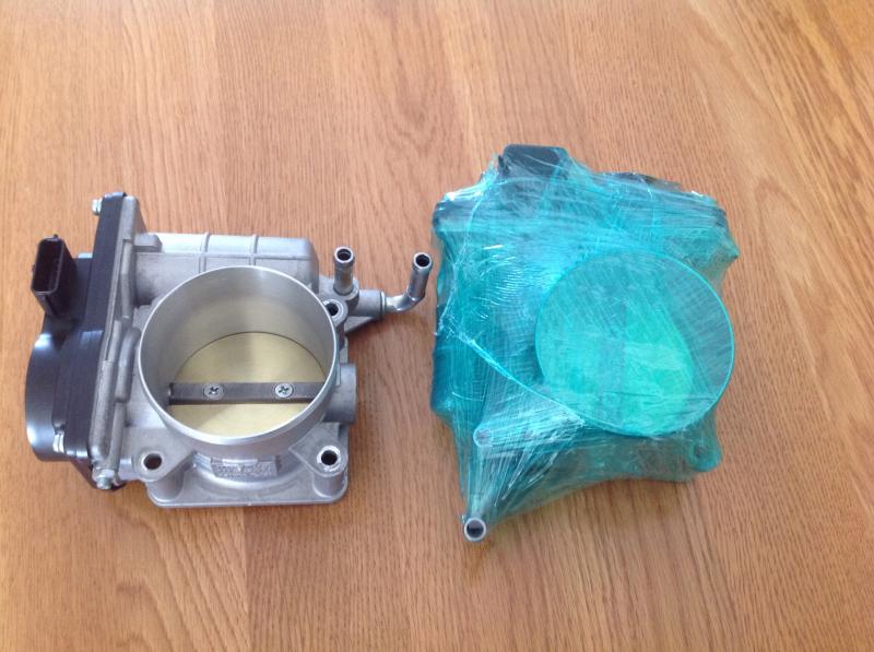

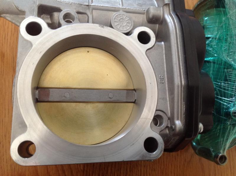

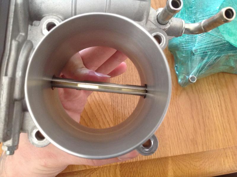

Pics from the porter. unlike the ones on mine, these have a full profiled butterfly shaft and flat head screws!!
