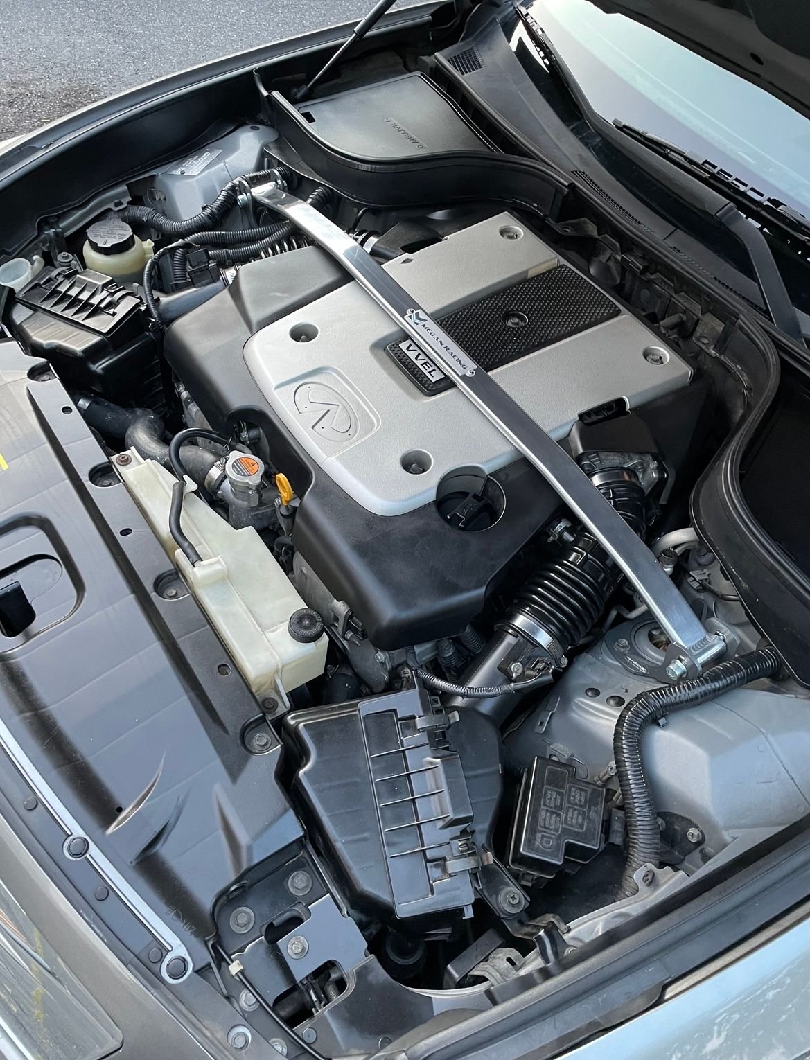

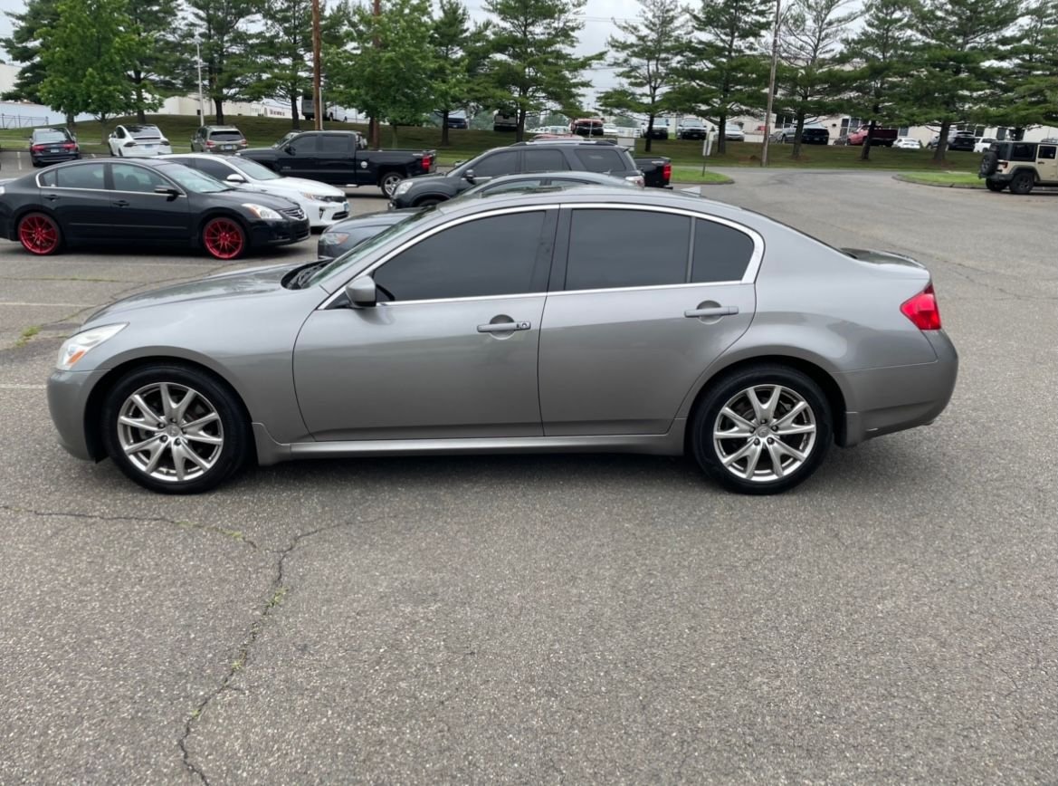

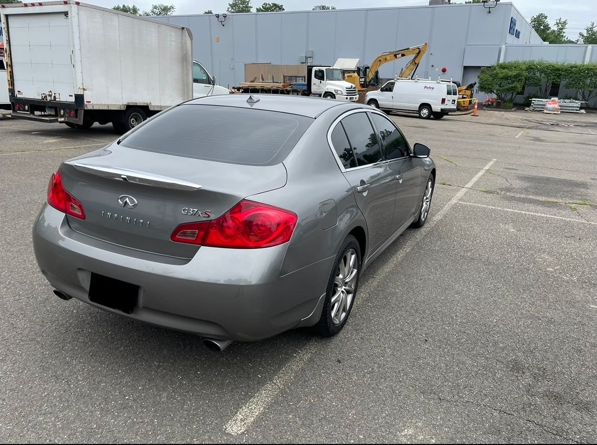

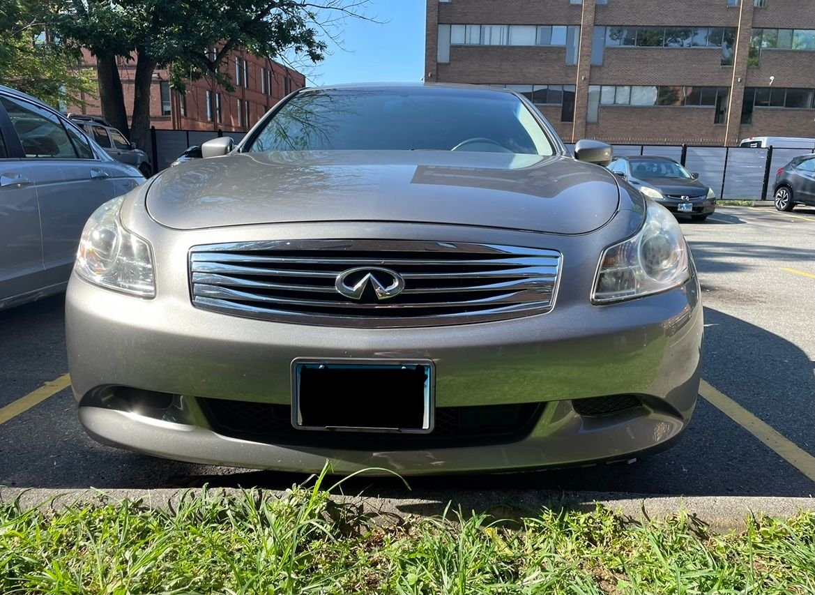

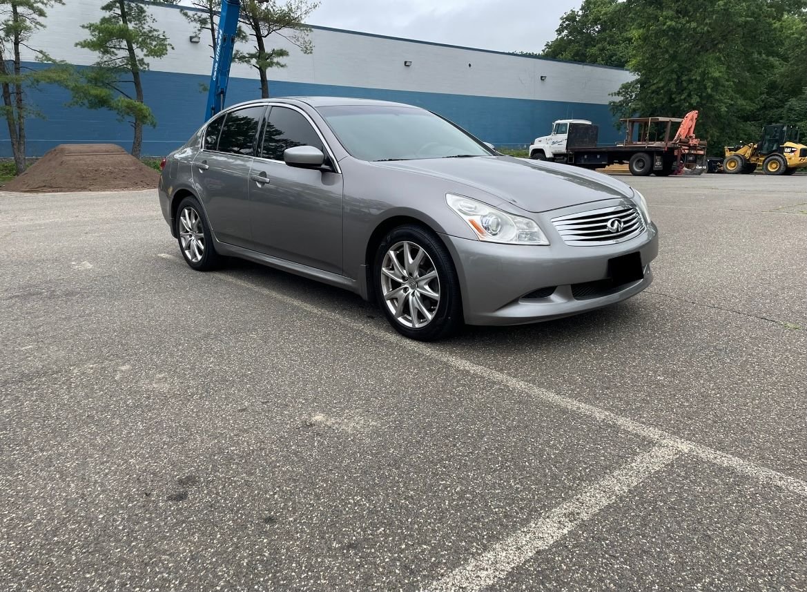

So I just got this 2009 G37xS (7AT) AWD with 148k for about $10k. I’ve had it for less than a month and I’m in love! It’s my first car so it’s like my baby right now. I want to make sure it gets the proper TLC so I wanted to know if anyone here had any suggestions or advice. She runs great and there’s no immediate concerns. I’ve already taken her to Infiniti for an inspection and they’ve “recommended” quite a few things… I’ll list them here;
Left Front Lower Control Arm - $895.82 plus tax
Front Brakes and Rotors - $434.99 plus tax
Right Front Caliper - $364.99 plus tax
Water Pump and Rear Timing Cover - $3,595.08 plus tax
Drive Belt - $259.99 plus tax
Valve Cover Gasket - $322.50 plus tax
4 New Tires - $1,076.00 plus tax
Spark Plugs - $475.00 plus tax
Engine Air Filter - $45.00
AWD Service - $389.99 plus tax
Brake Fluid Service - $159.99 plus tax
FIS Service - $389.99 plus tax
i know I’m due for a coolant flush soon as I can’t see any in the reservoir, I’m hoping that doesn’t turn into something lol. Other than that I’m probably going to tackle the water pump at some point soon along with the gaskets, spark plugs, and drive belt at the same time. Then since my filters aren’t really bad at all, I’ll wait a bit and throw in Z1 CAI. Then upgrade to big boy brakes, get some new rims and tires, drop her down a little and throw on that control arm. I figure I’ll bring her to Infiniti for service in the coming weeks but altogether the brake fluid just got serviced before I got it and idk what FIS Service is??
Again any advice or suggestions are appreciated! I’m super excited and want to take it a step at a time. Thanks!
Everyone, meet Trina!
