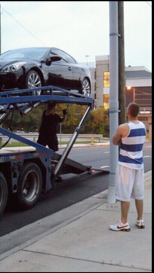

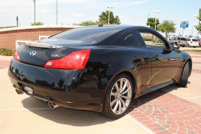

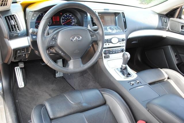

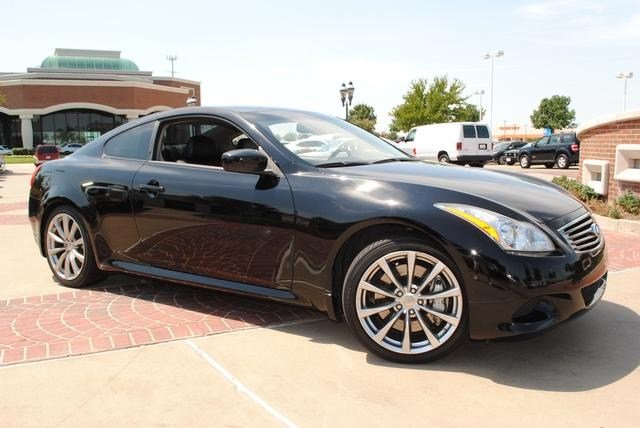

Plus some pics of my new ride. Nothing new you haven't seen but there they are.

Crazy question
Where did you get that car from?
Old Oct 10, 2012 | 12:55 PM
brandzimm's Avatar
brandzimm
Posts: 34
From: Charlotte
I got it from 5 Star Ford in Fort Worth, Texas
