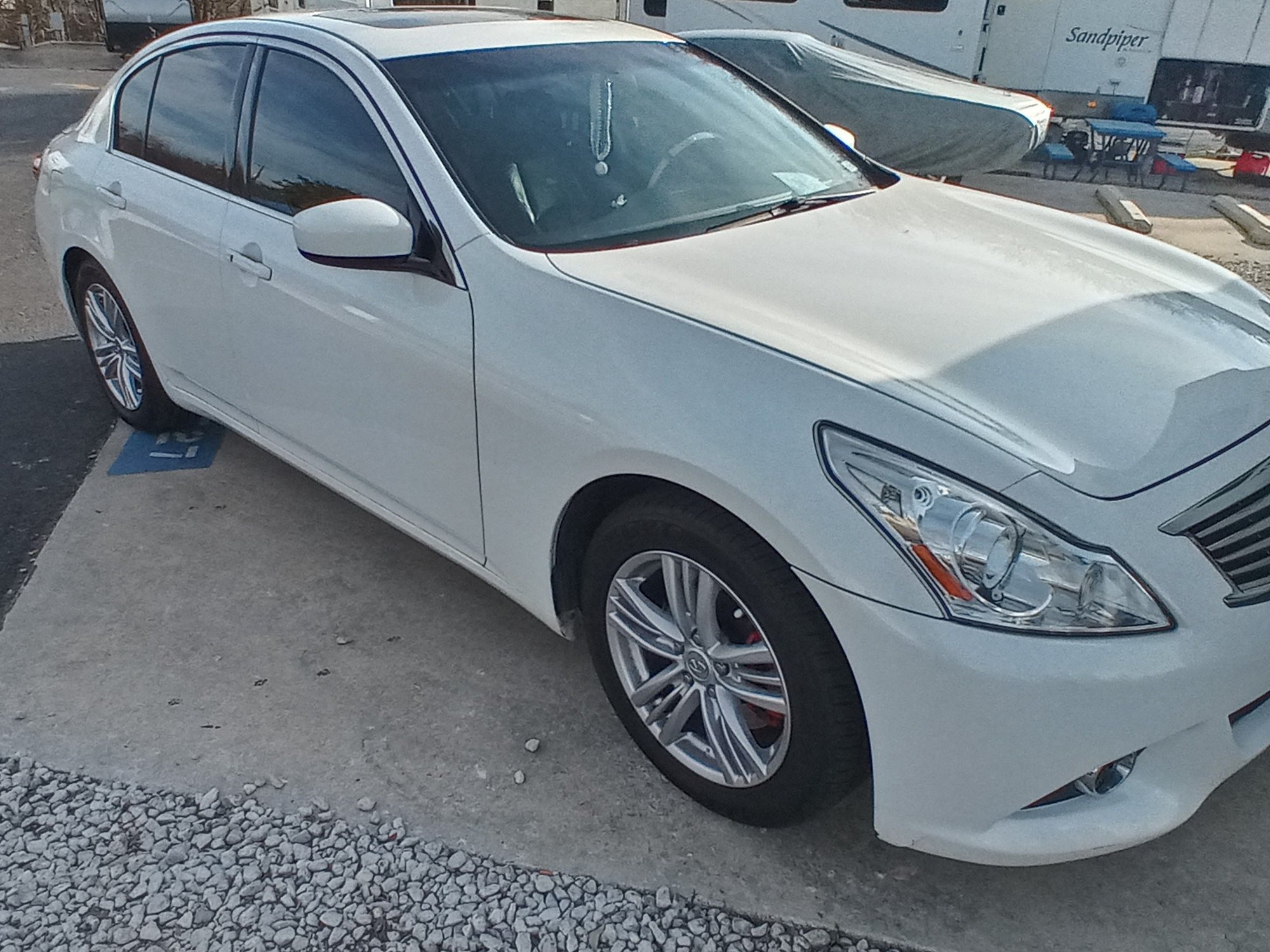

Hi everyone 🙂 how are y'all doing today? I have a 2012 G 37 and she is my baby!! I love my car.. but I'm having a problem and I need help.. So I have had a issue happen like this before but corrected it self quickly.. so when tropical storm claudette come through a couple weeks ago it blew water in somewhere !y driver's side floor and back driver side was soaked big time. I cleaned it up asap and tried to roll windows down they wouldn't go down do my goofy self rolled em down with the key fob and it worked but now I can't get them up. !y sunroof is not working , none of the windows, the dome light and the lock won't lock but will unlock even with the key fob.. anyone else have this problem

Thank you so much for the advice😊 I got the carpet up and it did get wet so I finally got the panel off and I pretty sure found the bcm. If it got wet can I blow dry it or will that mess up more? And it's a 2012 I believe sedan I just bought in January it's my first infinity and I love it.. best car I've ever had
