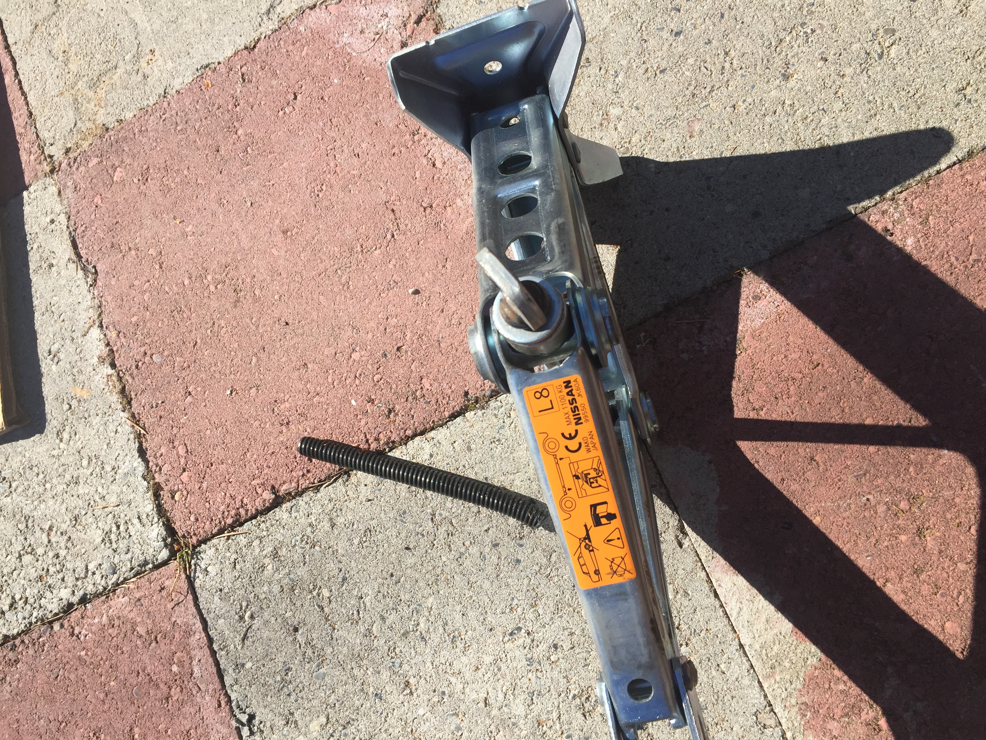

Long story short I was jacking up my car today to change out a flat tire, before I had a chance to put the car on to the jack stands for insurance the sissor jack snapped. One of those unfortunately events I suppose, anyhow this was my first time using the darn thing, I ended up finding one of my old steel jacks after I got over the WTF moment. Just wanted to remind everyone to be careful.
Attached Thumbnails PSA: Scissor Jack-image.jpeg

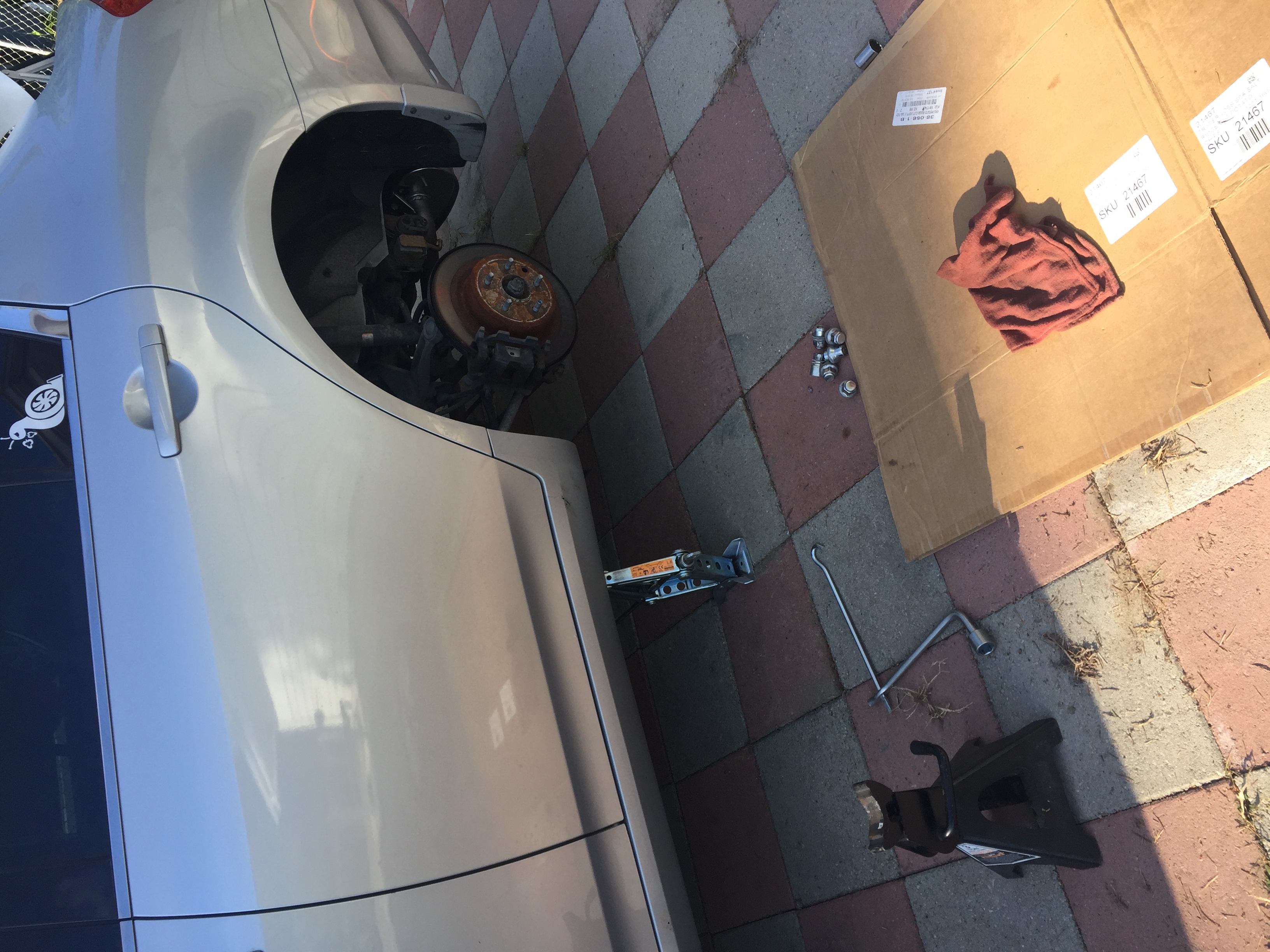

Here's a photo I coincidentally took before it fell, was excited to get this done until my Jack broke

Were you trying to raise it just enough to get the wheel off or to place the jackstand? I wouldn't trust these to go any higher than absolutely necessary to get the wheel off.
Got a pic of what actually broke on the jack?

scissor jacks are not designed to raise the vehicle high enough for you to put jack stands underneath the body or under suspension components. i can see in the first pic the scissor jack being fully extended into the highest position. this may be a case of user error instead of a psa.

It broke about 12 minutes into my tire replacement process. I had loosen the bolts to the rims (before jacking up the car) to make it easier to take off the wheels. I was about to insert the jack stands in when I heard a snap and the car went down. I'm glad nothing big got damaged (dented brake rotor dust cover & minor scraps to the undercarriage).
