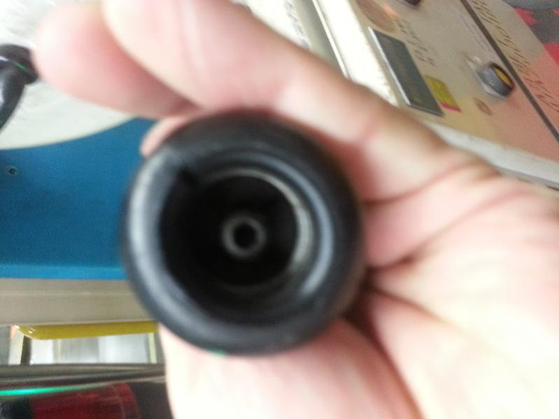

Originally Posted by '11G37S
There should be something you can turn at the bottom of the handle to recalibrate it if it's off. We check all of the torque wrenches at work twice a day and they are usually with in 10 lbs of the target. Any more than that we have to twist the bottom piece until it's with in spec.
Can you get a photo of this calibration gadget on your wrenches? What type are they? I've never seen one like that.
Old Apr 1, 2014 | 09:28 PM
  #21
Likes: 4,951
On the bottom of mine is a flat metal plate w/ a notch in it, looks like it could be taken off and possibly a way to calibrate but don't want to remove it if it's not supposed to be removed.
Old Apr 2, 2014 | 09:09 AM
  #22
'11G37S's Avatar
'11G37S
A 1/4 mile @ a time
Posts: 1,840
Likes: 173
Here's the picture. I apologize for the blurriness. We aren't allowed to take pictures inside the building so I had to take it quickly. They come with a key that fits the groove that will adjust the torque up or down if needed. Unlike the one I posted that I have for my personal use, you can't adjust the torque by turning the handle.
I'll try to get a better picture later today.
