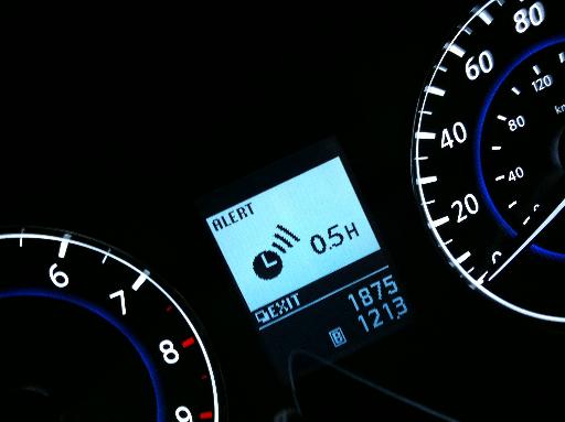

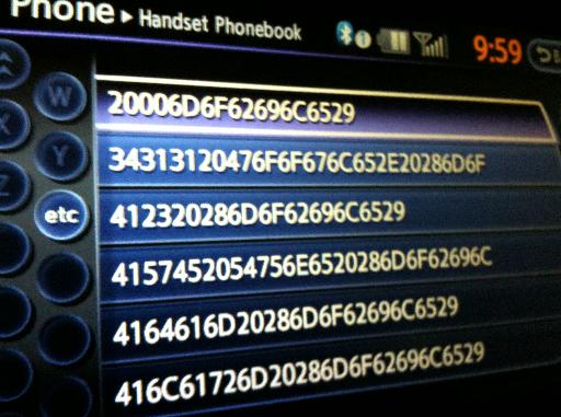

2 questions
i didnt seach because i wasnt sure what to search for.
im not sure what this means? i see it randombly. anyone know?
when i connect my phone via bluetooth. this is what my call history looks like. sometimes even my "handset phone book" looks like this. anyone know why this looks like this?

the first one looks like some kind of timer with an alarm.
second one is an error in the way your contacts get transferred via bluetooth. what kind of phone do you have?

yea i dunno what timer is set lol. i didnt know my car had an alarm clock? lol i have an iphone 3gs

I have the same issue with iphone 3GS..... I guess we need to learn the new hexa languages to interprete.... OR Infiniti comes out with some fix for it.

i called infiniti, he said the 1st gen iphone is the only iphone that has been approved as compatible. even though its a 2010 model car. he said the 3g and 3gs are not compatible. this is retarded. he also said iphone firmware 2.1 is the only firmware approved. this is also retarded because firmware 4.0 will be out next month.

Never seen the first one, perhaps a "rest timer" that you can set to some predetermined interval. I've seen them used to alert drivers over long drives they may need to pull over and rest.
Second is an issue with the iPhone phonebook getting corrupted during transfer. Seems to be a common problem. Unless you update your contacts list often, delete the phonebook, re-pair your phone with the car, re-download the phonebook, then go into settings and turn off the auto-download feature.
Yea that is what it looks like.. the rest timer. My 09 has the same thing which I turned off, I think it's turned on by default so you have to go in the menu and mess with the settings.
