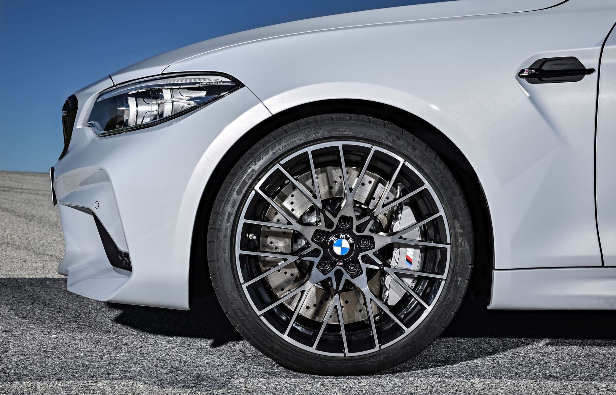

Which is more important for dissipating heat on the track?
Here comes the age old debate between bigger rotors and bigger calipers and which one actually dissipates more heat during track days. The obvious answer is that bigger rotors COMBINED with bigger calipers would manage heat the best. Sometimes both options are not possible together so let me explain the two reasons I am asking.
One, I am vaguely considering upgrading my front calipers to the Brembo 6 piston front calipers and know the feel of the brake pedal and stopping distance will probably improve, but will the larger caliper also help deal with heat better? Two and more likely, my next car is probably going to be a Cadillac ATS-V or a BMW M3 or M2 Competition. The ATS-V has slightly larger front rotors than our G37S cars with Akebono brakes and slightly smaller rear rotors, but much larger front 6 piston front calipers and 4 piston rear calipers. The M2 has calipers similar to our cars, but much larger rotors than both the Akebonos and the ATS-V. The M2 Competition is the ideal solution with bigger calipers and rotors than any cars I mentioned already.
Let's pretend for a second that the ATS-V and M2 weigh the same, have the same tires, the same blank 1 piece rotors, and the same suspension so weight transfer is identical when braking. Which set of brakes manages heat better and why?
The large 6 piston front calipers on the ATS-V
The large front rotors on the M3/M4 with moderately sized 4 piston front calipers.
The enormous front rotors and 6 piston front calipers on the M2 Competition. Sweet!

I just discovered something interesting about the front 6 piston calipers on the M2 Competition. Because they came off of another BMW never intended for track days (probably some suv) they have a non-removable stiffening brace that goes right over the top of the brake pads. This means that you have to remove the entire caliper just to swap brake pads at a track day. Bummer.
