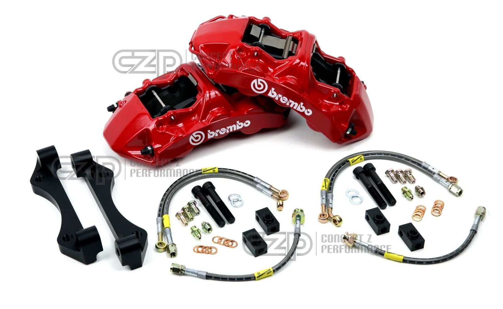

So if the 6 piston Brembo calipers only marginally increase bite and thermal resistance, then the question becomes, "why would anyone blow $2,400 on these calipers for our cars that use the stock rotors?" Especially since the middle brace makes it impossible to change pads without removing the entire caliper.
Bragging rights. Appearance. Delusional rationale.
It's all relative... why does anybody do anything to their cars? I mean, who here hasn't done something they don't need and doesn't really help matters on the street, or on the track?
That's all. Imo, and I can be opinionated 😉, the 6 piston calipers bring nothing demonstrable for 99.999% of drivers. Assuming a little more caliper piston area, slightly longer pedal travel, and therefore a slightly longer modulation range. Something no one will notice.
That's what I was thinking. I guess I will have to find somewhere else to blow $2k on car parts.
