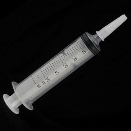

I bought a pack of these on amazon a while back. Something like $10 for a 10pack.
What do you guys use to extract extra brake fluid from the reservoir?-yiqb1ut.jpg
Great for sucking fluid out of the brake/clutch reservoir's and power steering. Attach a small hose for more flexibility.
Yeah, that's the syringe I was trying to explain. Should work great,

I've used a turkey baster before. They just don't seal very well. These things are medical grade and get the job done.
Note, label which one is used for what so you don't contaminate fluids.
Awesome, thanks! That looks very similar to what I was using in the past. Sounds like it seals well for you too? That had a turkey baster at Advanced Auto parts, but we tested it with water and it leaked all over the place and the last thing I want is to leak brake fluid on my paint as I pull it out of the engine bay.

I have a 20ml syringe that I use. Nice and thin so it gets right to the bottom of the brake, clutch and power steering reservoirs.
If you have a pet shop (maybe?), or even horse/livestock feed shop (ie, Tractor Supply) nearby you can buy single units there for cents.
I tried the turkey baster and just made a mess of things, it's now in the bin. Don't waste your time or money.

I picked up a 3 pack of syringes at Fleet Farm yesterday for about $3 which will probably last me a decade. You are supposed to thread a needle into the end, but I think they will work fine. They definitely seal a lot better than the one I was using and are even sterilized since they are for animal use. My brake fluid never had it so good.
