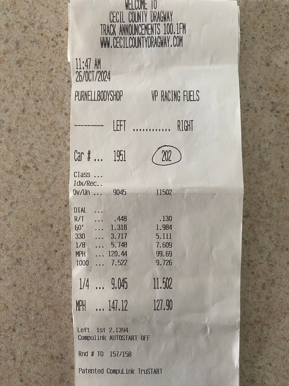

2009 SE
DAN
RWD
7AT
Fast Intentions Twin Turbo, Tuned by Seb from Specialty Z
Michelin Pilot 4S Tires

Originally Posted by rx794
11.50@127.90
2009 SE
DAN
RWD
7AT
Impressive. Which Stage FI Turbo Kit are you running?
https://fastintentions.com/product/v...-turbo-system/
Any modifications to the 7AT, or are you keeping the boost low to prevent issues?
Old Jan 19, 2025 | 12:17 PM
  #63
rx794's Avatar
rx794
Joined: Sep 2006
Posts: 88
From: Long Island, NY
The turbos that I’m using aren’t listed on the Fast Intentions website. Seb from SpecialtyZ spec’d them out. It’s something inbetween Stage2 and Stage3.
The car is running a VR 7AT with a transmission cooler. The VR 7AT can handle a lot more torque than the stock VQ 7AT. So for now I’m ok and it should still be fine once I turn it up some more.
Nice What did it run before the TT setup? NA?
Nice. So you did the V30 to G37 7AT swap. Where did you find a VR30 trans?
Followed this route?
https://www.godzillaraceworks.com/te...ur-zg-platform
No gotchas?
I never took it to the track when it was NA.
Old Jan 20, 2025 | 12:48 AM
  #67
rx794's Avatar
rx794
Joined: Sep 2006
Posts: 88
No gotchas?
I used Godzilla Race Works for the machining of the bellhousing and the aluminum driveshaft for the VR transmission.
