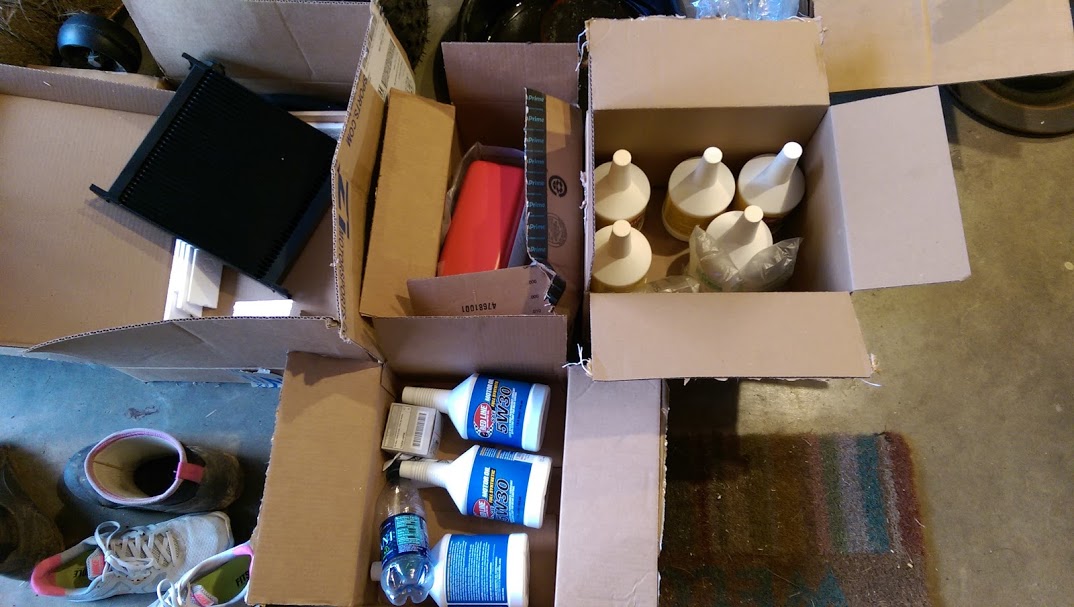

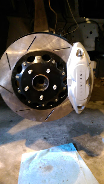

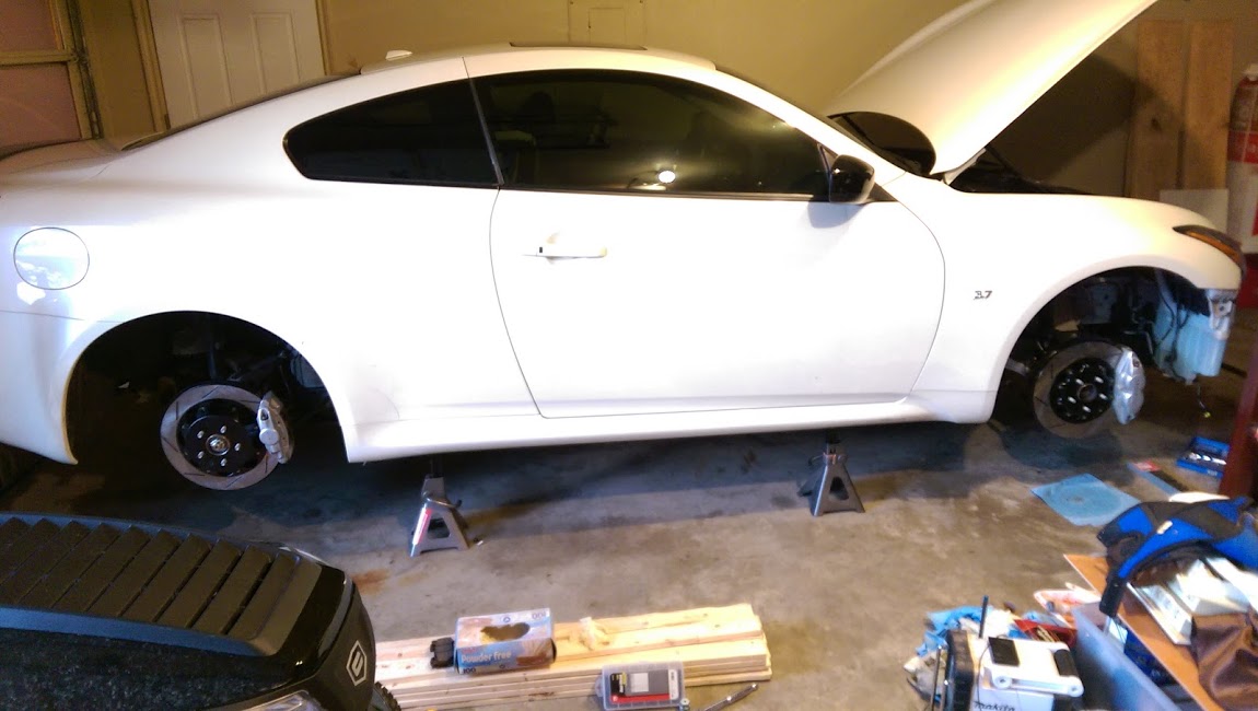

Well it's been a long time coming, but got some work done on the Q this weekend ahead of a track day at the local track, Grandsport Speedway in Houston, Tx. It's a dinky little 1.4mile track with a lot of hard braking zones. I installed Z1 2 piece slotted rotors, carbotech XP10/8 pads, stainless brake lines, oil cooler and full fluid flush with redline.

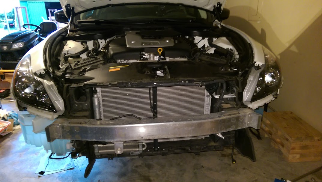

I have purchased brake cooling ducting but once I pulled the front off the car I realised it wasn't going to fit. The Q must be slightly different to the G around the washer bottle, it's different to what I've seen in all the photos and I couldn't follow the oil cooler install instructions as the routing is different and the power steering cooler lines hit the washer tank if I used the included mounting spacer. It also meant that there is all of ZERO room to run brake ducting on the passenger side, I would have to utilise the space where the foglights are as the intake and remove / install a smaller washer bottle, the oil cooler lines take up all of the available space so there is nowhere to run 2.5" tubing.
4DRZ, I am trusting from your experience that the ducting is not 100% necessary and I'm hoping that the 2 piece rotors help. They are directionally vaned and being 2 piece have quite significant air gap in the inboard and outboard side of the rotor, so I hope that can help pull air for cooling in to the rotor.

But, I did get to work the brakes in a bit during my 140 mile journey. They are SUPER noisy. The pads don't have a chamfered edge and they rumble something chronic over the slots. I have slotted rotors on the race car and haven't had this, but can only assume that is what it is. It's worse on light braking at speeds under 40mph (aka street driving). Now that they've had some work the pads also squeak like crazy. Otherwise, they work really well. Obviously I haven't had a chance to test them on the track, but so far the pedal feel is really nice and these work just fine as street pads in terms of cold performance.

The noise is probably your rotors. I have used the XP 12/10's on solid rotors, and they weren't any noisier than stock pads. On my other car, I have slotted rotors, and howl under braking from high speeds. Not Carbotech pads, but they howl with various pads. I'd chalk that up to the slotting creating a resonance.

Just having lunch now, but lost my last session after I found power steering fluid all through the passenger side wheel well and initially thought it was brake fluid. Checked all the lines and pulled the inner fender out before finding the source. It was OK on my first run, but that was 15s per lap slower.
