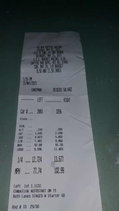

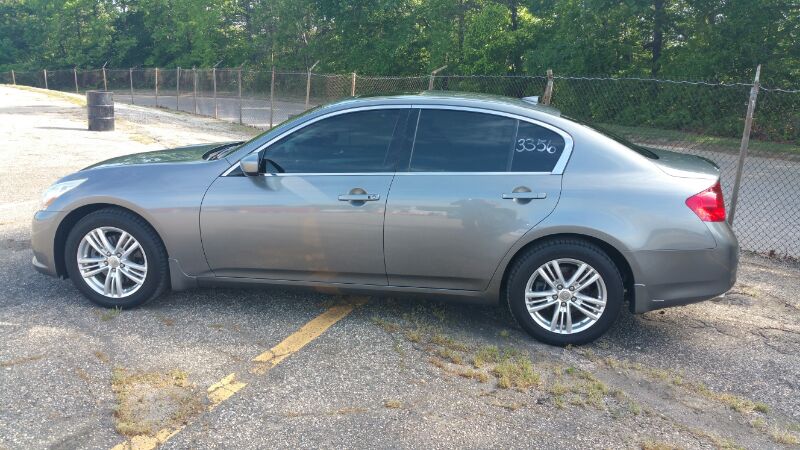

I went to the track and had a disheartening time. I haven't gotten tuned yet but I was still expecting to be under 13.5 in the quarter. This was my fastest time of the day and it was me manually shifting my 7sp auto.
Attached Thumbnails 1/4 Mile Times G37-img_20150518_4630.jpg   1/4 Mile Times G37-img_20150518_30793.jpg

I go to Capitol all the time also. Probably you are running lean with all your breathing mods. More air needs more fuel to make power. If you are done with your power mods go and get tuned. Hills Garage or Moore automotive can do it for you.
