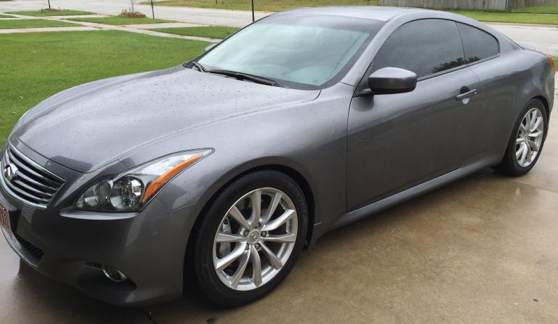

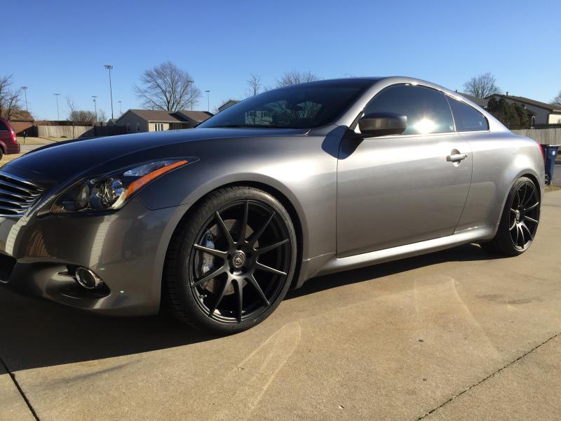

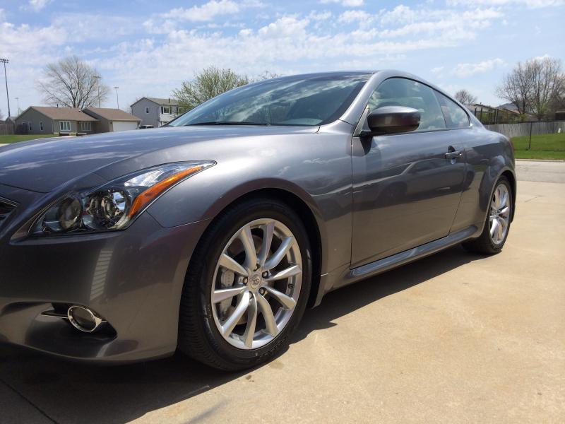

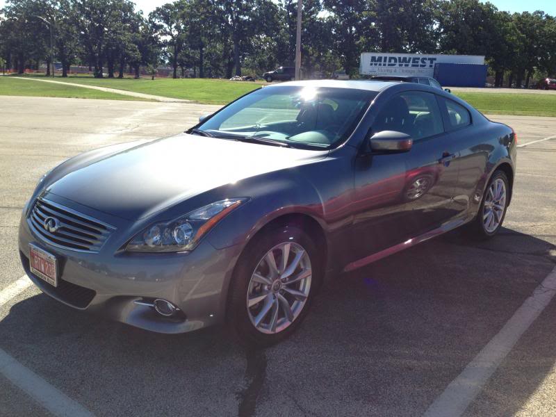

I started lowered on the factory wheels and tires (18x8 +43) and did not have any rubbing. I quickly added 20mm spacers to the front, and 25mm spacers to the rear resulting in the front size of 18x8 +23 and a rear size of 18x8 +18 and also did not have any rubbing. I recently installed Forgestar CF10 wheels in the following sizes with 255/35R20 tires all around: Front- 20x9 +28 Rear 20x10.5 +35 I do not have any rubbing with this setup either.
Before Lowering:

After Lowering (no spacers):

After Lowering (20mm spacer front, 25mm spacer rear):

After Lowering w/ Forgestar CF10 Wheels (Front: 20x9 +28, Rear: 20x10.5 +35 - All tires are 255/35R20):
All setups had in specification camber. Front and rear SPC camber kits are installed.
