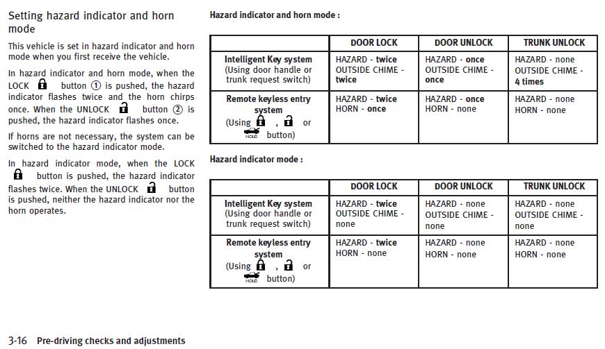

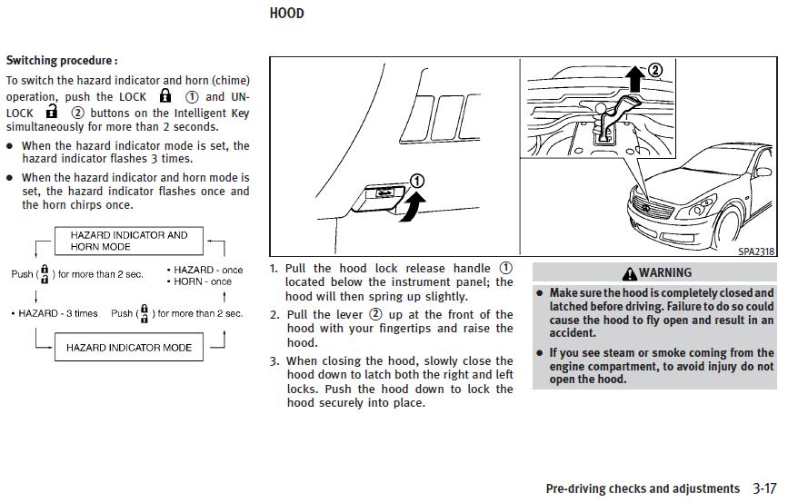

The G37s have the ability to toggle between two modes called "hazard indicator and horn mode" and just "hazard indicator mode". Looks like you need to hold both lock and unlock buttons down for 2 seconds. I'm guessing that is how you got it switched on you. I know you can change the settings on the menu screen. I think its under settings then comfort. But I'm not near my G right not to check.
I'll attach the owners manual pages on how to switch modes with the remote and what the modes mean.
later,
Curt

Well, I'm an idiot. I could not find any settings in the menu screens to change the beeps. Its only via the remote to toggle between those modes. I must of read the manual at one point and thought those two modes could be found on the menu screens. Or I use to live in some other reality. grrrr.
