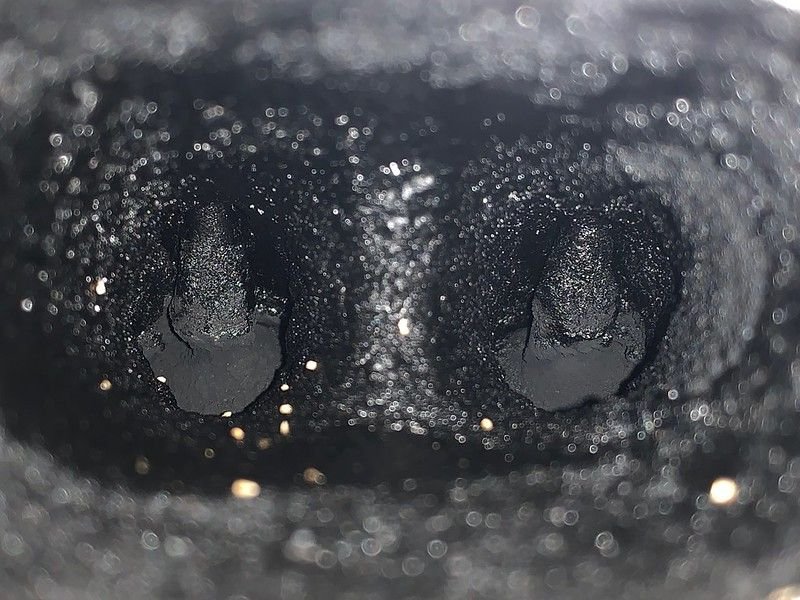

Hello, I have ventured to change the valve cover gaskets, and after I took the Plenum off, I took a peek inside the valves, I found there is oil residue (not carbon build up) on all of them (see pic) where is this coming from? Do I have a bad head gasket?
For a bit of history, the car did overheat one time, but it did not show any dash lights, so I didn't know, then the engine shut itself off while I was driving, I was very cold outside as well. I repaired the coolant hose and filled with coolant. I drove it about a 1K miles more and did not lose any coolant, neither did the coolant seem to have oil, also, oil consumption is normal.
2010 G37 143k miles.

Oil consumption isn't normal on the VQ37s, but at 143K miles it could be present. But the fact that those black lines are perfectly bilateral seems to indicate that it's carbon (port injection, so the fuel sprays across the bottom of the valve) you see not oil as it would seem unusual to me that the head gasket would leak in the exact spot on both sides of the chamber. Maybe one of the others with more of an automotive background could comment.
In looking at this pic, where is the spark plug? six o'clock?
Also, are you the user on the Reddit sub that bought a used G from the Texas Drift Academy?

Here is another picture, some are valves are better than others. This seems to have the worst oil.

Thank you for replying. I posted another pic, and it appears to be oil instead of carbon.
The spark plug was 3 o'clock.
I'm not that Reddit user

Excellent. He was complaining that VQs are known from burning oil and used his whip as an example. He then disclosed a minor detail that he bought it from a "Drift Academy". There's no metallurgical magic that can keep cars which spend most of their lives being driven hard from consuming oil.
Let's see what some of the others say about the pattern you've discovered.

This is Oil consumption from bad valve seals. You can see in the close up picture that the valve guide has debris around the lip. This oil as it sees vacuum upon deceleration is forced into the intake port and this oil spray covers the back of the valve.
The injector then sprays and washes the front part of the valve however is unable to clean other parts so it wets the oil, that moist oily residue then dirties up and then attempts to dry. Because it cant dry it stays there.
Valve seals will be your only fix.
In my opinion, this fix usually shows age of the engine which to repair is much more money and work than replacing the engine itself.

The wonderful joys of port fuel injection.
Look at how clean the vales are after 143,000 miles.
No direct injected engine will look that free of carbon build up at 100,000 miles!
Anyways...
That tiny bit of carbon is nothing to worry about.
The PCV system introduces a little bit of oil vapour to the intake and when it hits the hot intake, it may collect a small amount.
