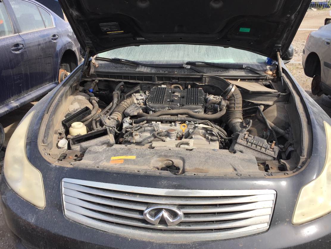

Just to show the dirt on and around the engine, here is a pic before I started:
