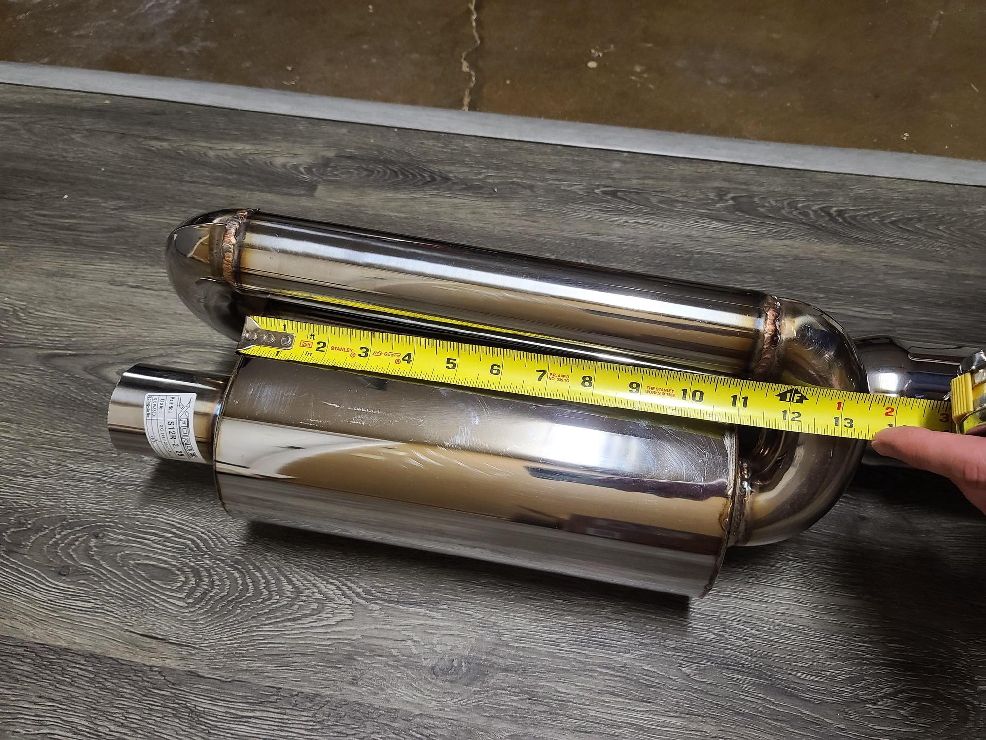

I have purchased a muffler and taken some pics. It's the Xforce S12R-2.25 Twin Loop Muffler. The quality of the welds and material seems to look fine to me, although I have no welding experience so I wouldn't be able to know for sure.
I wasn't exactly sure what to expect in terms of size and dimensions just going from what I've seen online, so I was curious what this thing actually measured and how it will fit compared to my Invidia Q300 mufflers.
Well to my surprise, the dimensions are very close to the same! There will only need to be minor modifications made to get it to fit after removing the Q300 mufflers. It's nice because the inlet is 3" long so it can be cut shorter if needed to make the overall length appropriate at the outlet tip.
The only thing that doesn't seem to line up right is the outlet tip under the bumper. It's going to be about 1-2 inches too far to the right. This can be solved by locating the muffler a little further up on the exhaust piping, utilizing the extra length of that 3" inlet tip. I'm not sure if the exhaust shop will just want to cut the Q300 pipe a few inches back and weld the Xforce on, or just remove the Q300 mufflers at the flange and weld an entirely new flange and pipe back to the Xforce muffler.
The other thing I was concerned about was the overall height of the muffler with the loop up top. I measured from the bottom of my Q300 to the heat shield above and it was about 8.5", whereas the Xforce muffler from bottom to top of the loop is only about 7", so it looks like it'll have plenty of clearance and wiggle room! Also, the location of the loop that you would normally be able to see from the rear of the car will be hidden mostly by the way the bumper is designed, and you'll mostly only be able to see the tip for a cleaner look.
The bad thing is that only the S12R model has been in stock, and I can't find the S12L in stock ANYWHERE right now. So it's going to be anywhere from 4-10 weeks I've heard from talking to some vendors until I get the other muffler shipped. I was really hoping to be able to get these swapped out sooner so I can take my car for a before / after dyno. I planned to dyno it regardless so this will be a nice test to see how these mufflers affect performance compared to the Q300 on a moderately modified car. I'm hoping to see a 4-5whp+ gain.
The benefit of these compared to a chambered muffler? Maintains a level of quietness utilizing different methods of sound cancellation, good throttle response and torque characteristics, while being able to flow better under high load. Take this picture from Mugen's twin loop as an example.
Here are some pictures I took.

I had a small exhaust fix done this weekend and I was able to get a few more pictures of how the twin loop muffler will line up compared to the Q300:

Man, these are great pics of the process and analysis of these cans. So is there enough vertical clearance for these things?
The sound better be worth it, because OMG these look silly. Then again, the looped pipe is somewhat out of sight.
Side tips instead of centered. Hope this works with the bumper cut-out, seems iffy.
Yep the vertical clearance should be good. My Q300 measures 8.5" from the bottom of the muffler to the heat shield on the car. These twin loops are 7" tall.
I don't expect the sound to be worse in any way compared to a typical straight-through design used by other brands. The point is that I'll be able to keep the noise levels down under light throttle and cruising, but it should open up nicely when I want it to!
The muffler shop will have to modify the piping coming from the last flange to make these work, but it shouldn't be too hard for a decently competent welder to make the tips line up with the bumper cutouts. The 1 thing I worry about is that the shop I used to fix my exhaust yesterday, uses crush bends. That's no bueno for me. So I may need to order the appropriate mandrel bent tubing online and just have it welded onto the new mufflers to make them fit right.

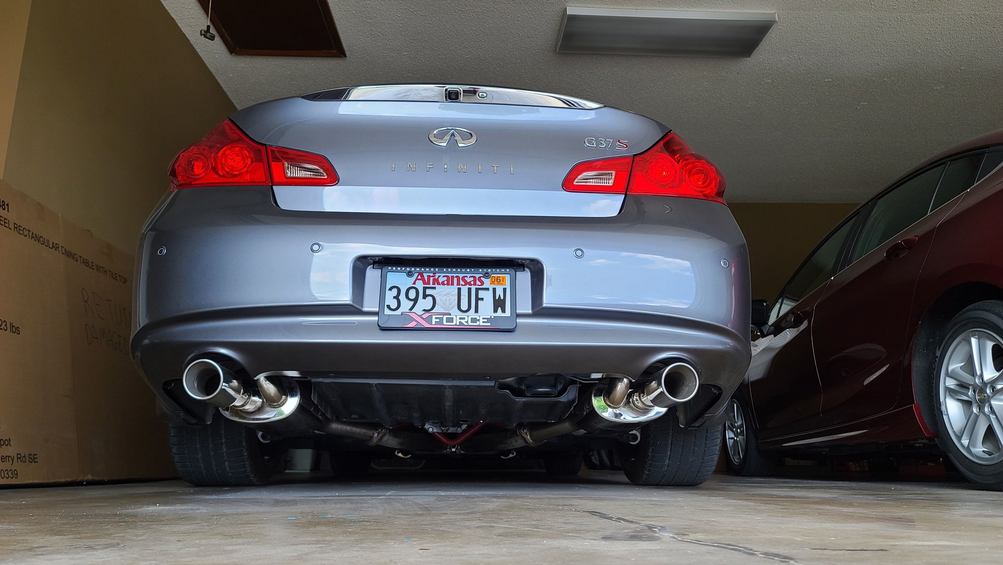

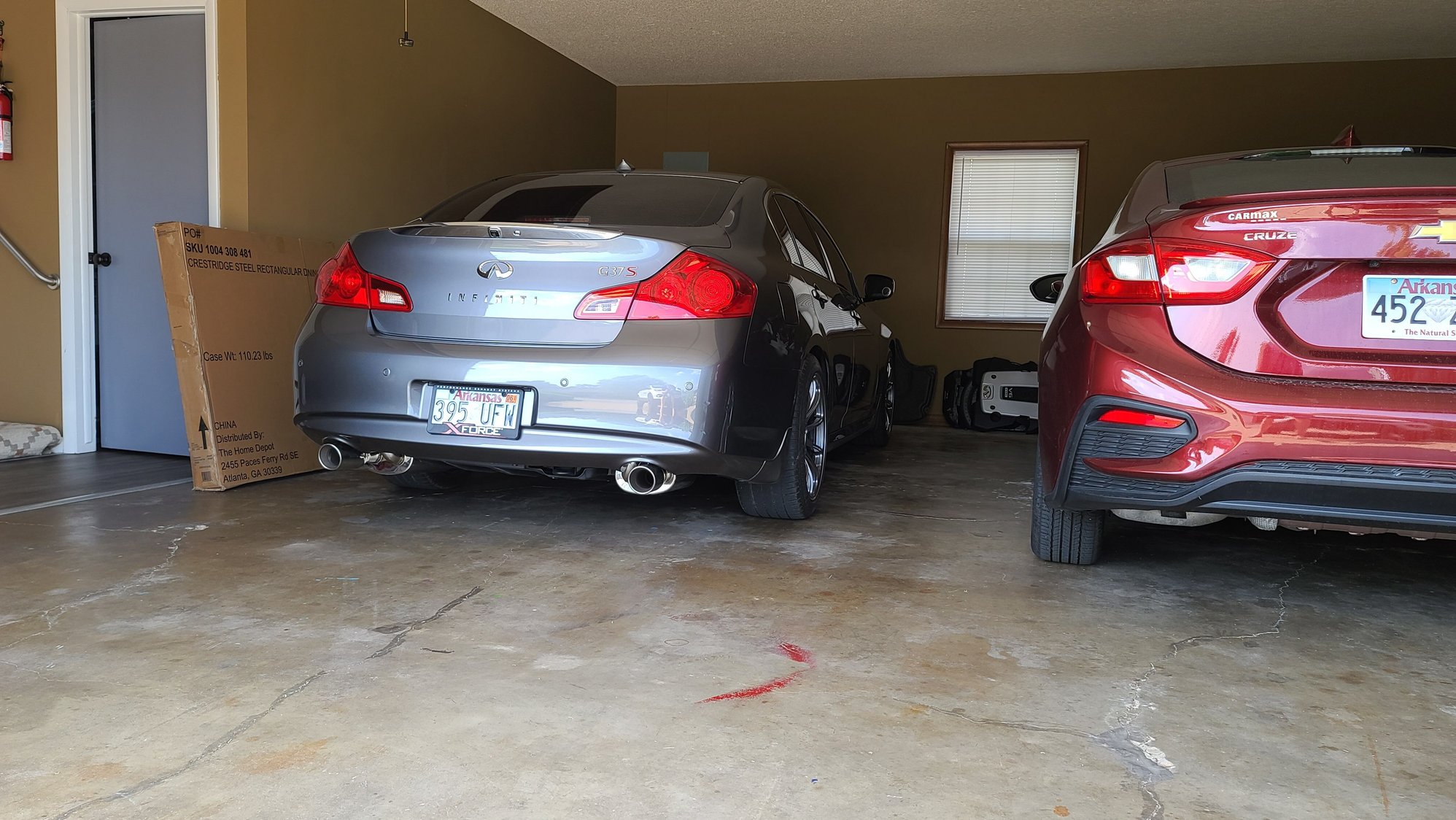

Well I got the twin loops installed. I had an exhaust leak (even before I installed the new mufflers) that I had to fix to the best of my ability, before I wanted to post any sound clips. They fit pretty well, the installer had to make a minor modification to one of the exhaust hangers though. I wanted to be able to easily swap my Q300 muffler back on if I didn't like the sound / performance of the twin loops, so I always have that option. Since I've fixed the exhaust leak and gotten a better chance to hear these mufflers, I have to conclude that I do like them more than the Q300s. Keep in mind, I have the Q300 2.25" ID catback, I just swapped mufflers to get a bit more sound and flow.
I planned to have it dyno'd August 3rd to see the difference in power between each muffler, but the shop had some problems with their dyno and had to cancel. They're supposed to call to reschedule, but I don't know if I'm going to do it because it will be over $200 and I recently had to get some dental work done, so I feel guilty spending the money just to see some numbers on a screen. If anyone wants to donate, I may be willing to change my mind! hehehehe
The Q300 mufflers weighed about 19.5lbs each with the connecting pipe and flange, whereas the twin loops weighed about 12.5lbs each. So about a 14lb weight savings.
Before video with Q300 mufflers and exhaust leak (sounds louder and better than it should, lol) -
After video with Xforce Twin Loops and a fixed exhaust leak. There's a little bit of a metallic buzz that comes from an exhaust repair job where they used a pipe expander to slide one pipe inside another, so it rattles / buzzes under heavy load -
Pics:

The twin loop looks great from the rear profile. It sounds like the original Invidia mufflers have a slightly deeper tone compared to the twin loop during the initial acceleration. The twin loop sounds louder but still very civil. i like it.

I can't say it sounds better, the original mufflers had a much more refined sound. I hope you are happy with your overall goals of this project.
However, I must say that intake noise is purely awesome

Yep I don't like the sound of this setup as much as the Q300s. But, I still like it, so I'm going to keep it like this for now. I really wanted to get that dyno done to see if there was a difference in power. That was part of my overall goal, make a bit more power and a bit more sound. If I do end up dyno'ing and there's no power gain, I'll probably switch back to the Q300s. My butt dyno is telling me that I have picked up some low-midrange power, it just feels a lot more responsive. It also seems like the tires spin more when shifting from 1st to 2nd during WOT.
And I'm with you on the intake noise, I love it!
