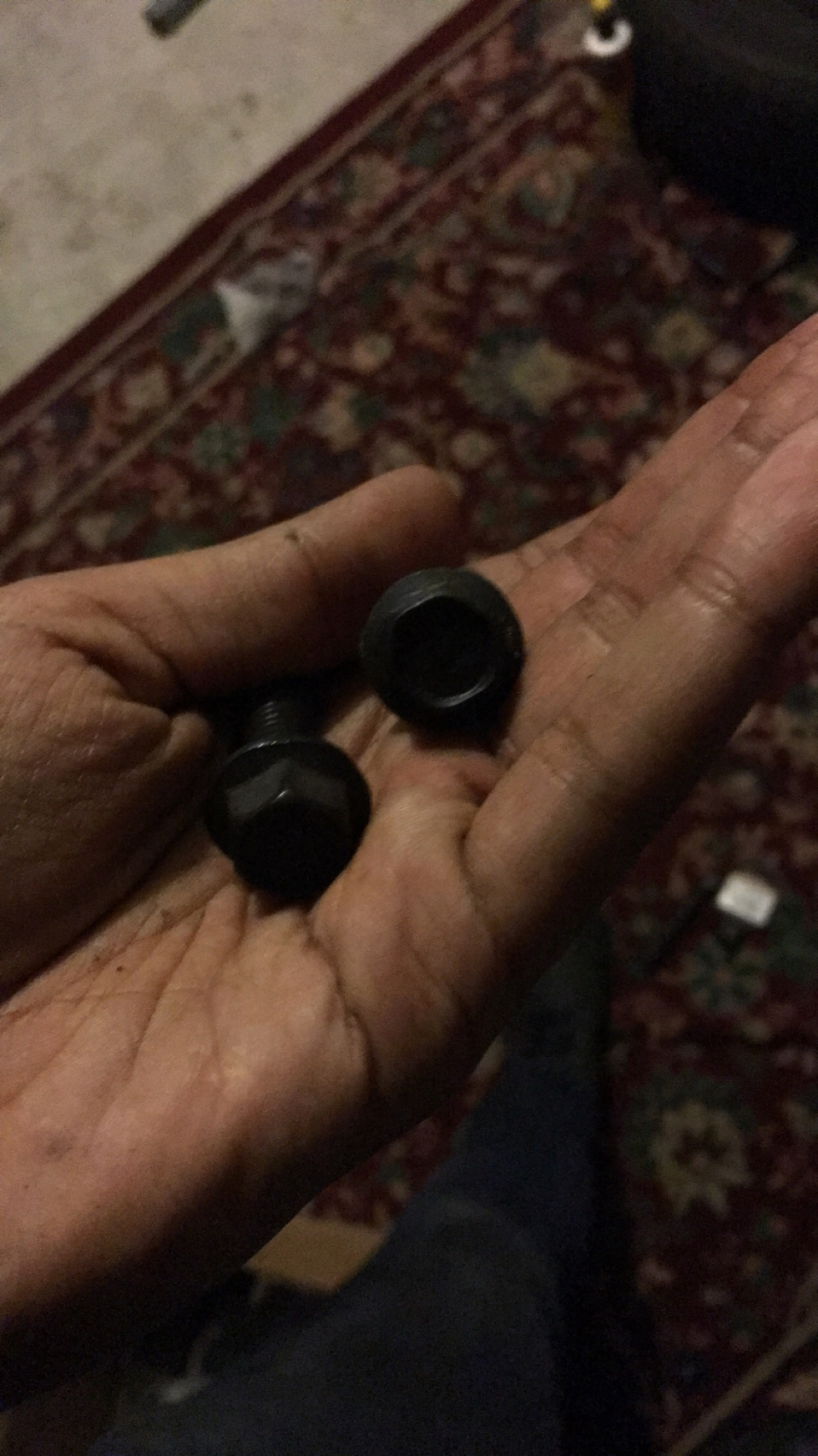

Got the pipes installed, had to use a saw for the y pipe bolts. But the demon bolts came off no problem. Just wondering if it's normal for the test pipes to throw smoke. I'm guess that's from the new setup and everything.
