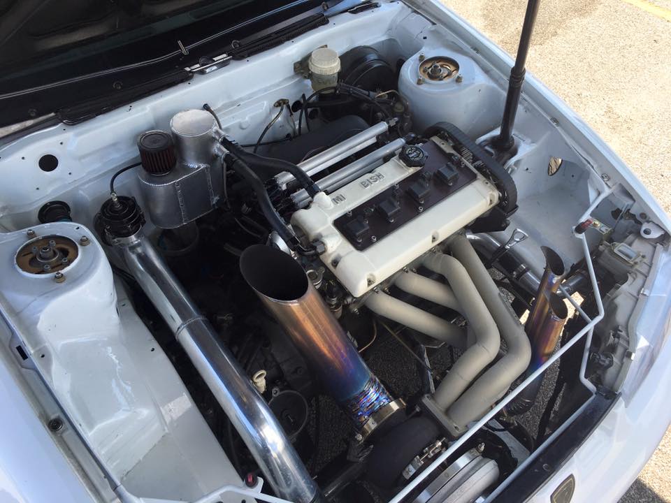

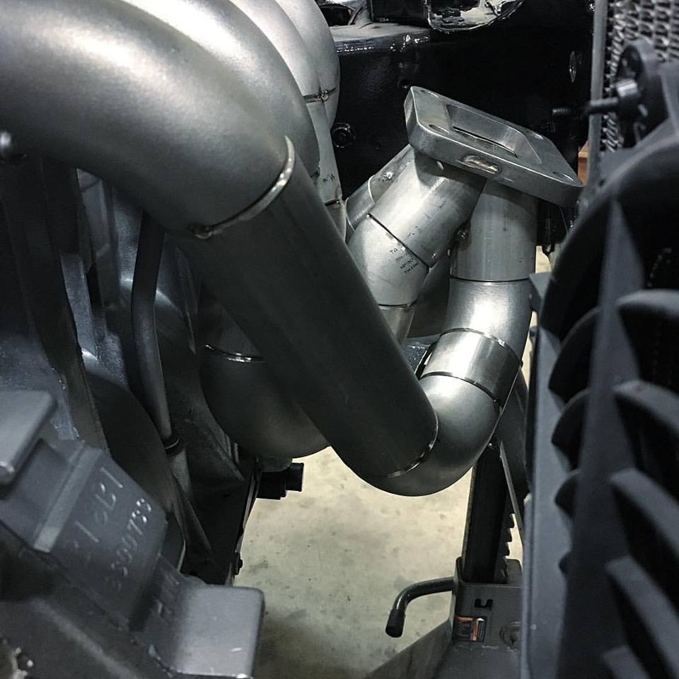

I bought this exhaust off of ebay because it's 304 stainless and has the beveled exhaust tips that I like. I know of a very good local metal fabricator (he specializes in DSM stuff, but his work is amazing) that is going to modify the exhaust to work on my G37 sedan. It will be several hundred bucks to have it modified, but I'm hoping to have about half the money in this exhaust as buying a new Ark grip:
http://www.ebay.com/itm/400981903721?_trksid=p2060353.m2749.l2649&ssPageName=STRK%3AMEBIDX%3AIT
Attached Thumbnails How to get more sound out of Sedan on the budget.-maston-fab-header.jpg   How to get more sound out of Sedan on the budget.-maston-fab-dsm.jpg
