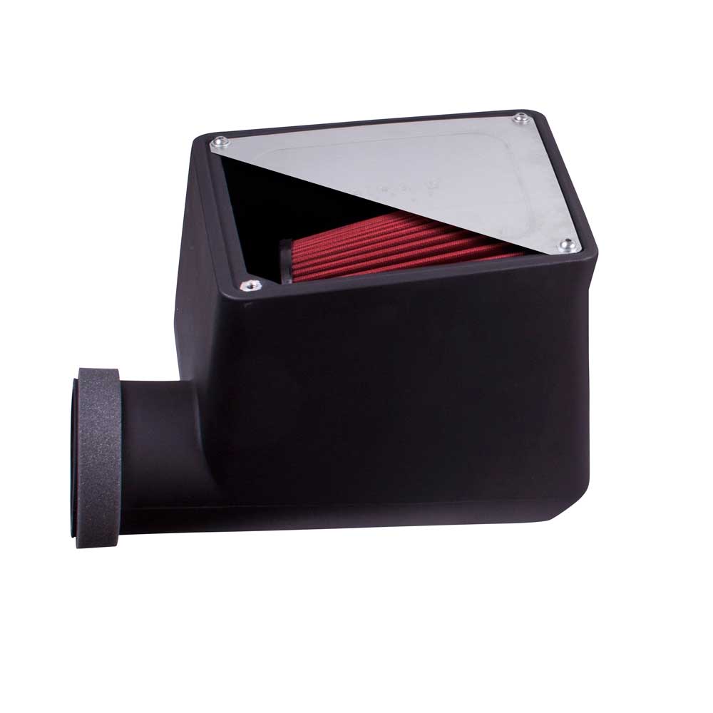

Here is the final setup with heat shields mounted and rumber trim seal around the metal.
I will be making a DIY for this either late tonight or tomorrow. Total cost came to $120.

Wonder how these would perform with the filters completely enclosed? This is great man, nice work.
