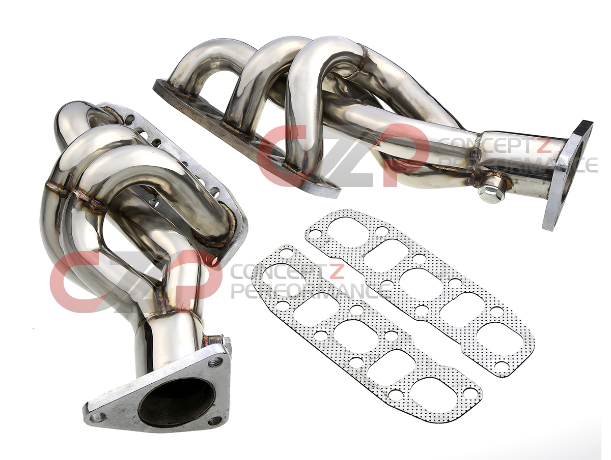

So I'll ask anyone here use these? Seem like the G35,350Z guys use them and had good things to say about them. We know their cat back is a good set up blnewt runs it,
So I might swings at these, at lease the drivers primary wont hit the motor mount like the momentum headers did :/
CZP sells these also
http://www.amazon.com/VQ37VHR-Top-Sp...d/dp/B012C5U1U

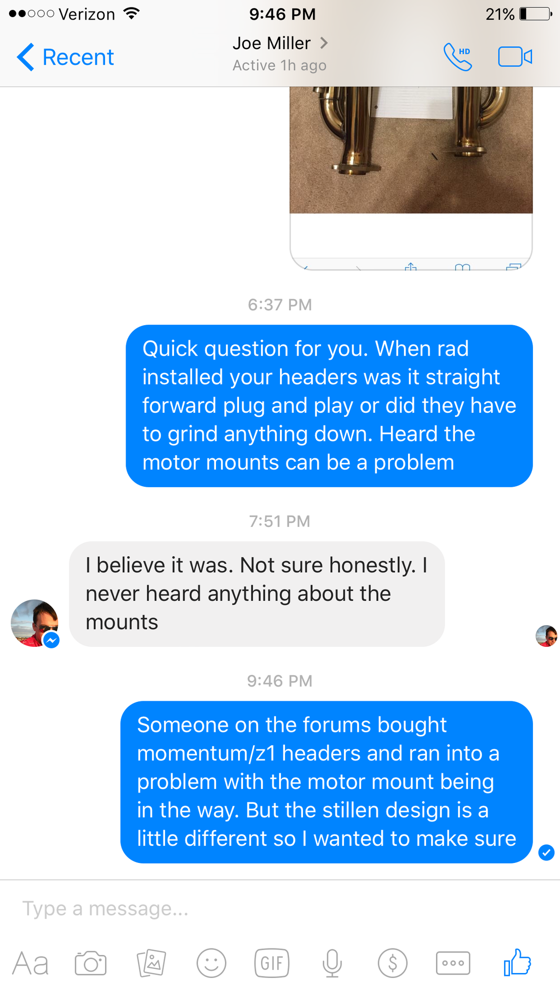

I know someone who has stillen headers on his awd sedan so they will fit for sure. Will ask him if the shop had to do anything to make it fit or was it strictly plug and play so to speak.

Baby Jumpman's Avatar
Baby Jumpman
iTrader: (18)
Joined: Jun 2014
Posts: 510
Likes: 66
From: Long Island
Old Dec 21, 2015 | 05:18 PM
Upscale Speed's Avatar
Upscale Speed
iTrader: (18)
Joined: Aug 2014
Posts: 923
Likes: 120
From: Springvale, ME
I should have my car back tomorrow got update today and initial report was that they fit without modification.
