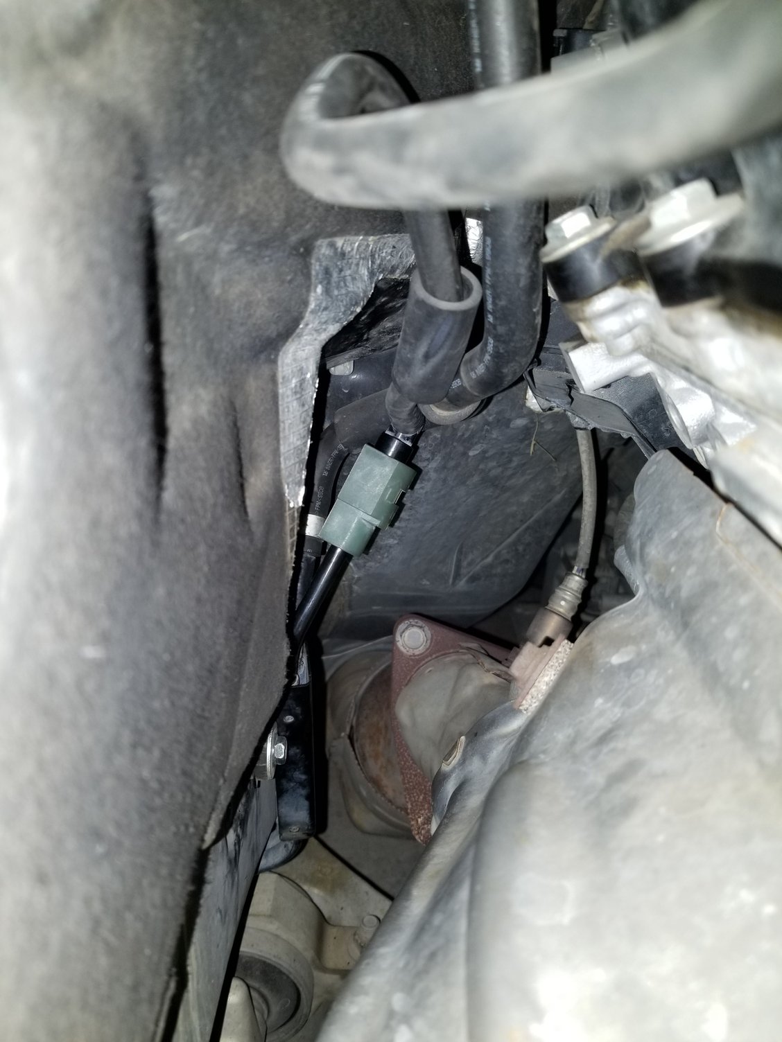

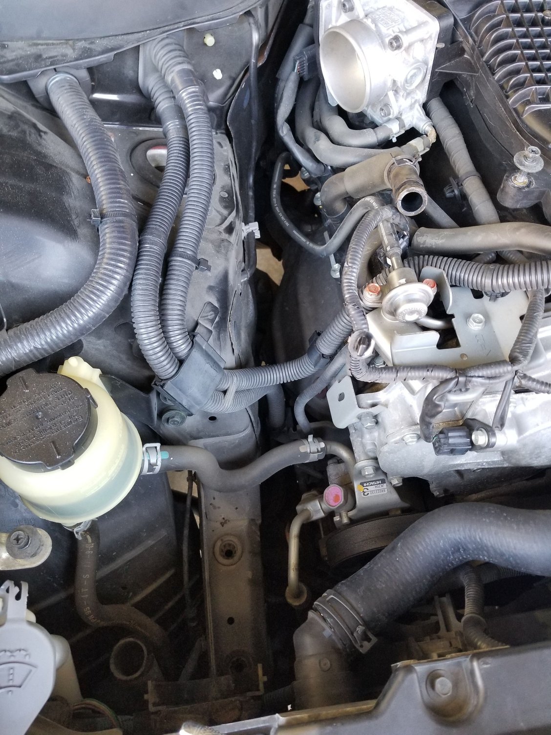

Finally got it done today. It was the 5?16" T-fitting (OTC Item # 32 or ITC Part # 518476). The location was down on the passenger side engine compartment near the catalytic converter behind some small metal shields. I had to take the air handler off at the large hose clamp attachment to the throttle body. There is also a small air hose clamped to the plastic part which is bolted to the intake plenum (on right side of picture below. There is one bolt on the air handler, then it "pops" out from (3) rubber inserts below the air handler. I had to remove the metal shield covering the fuel line connector. It has (2) 10mm screws (one on top of the other). There is a large plastic protector over the fuel connector. It just slides off sideways (no clips). Once that is removed, press the tabs of the green plastic fuel line connector. See pictures below.

after air handler is removed

Fuel Connector Before removal
Fuel Connector after removal

Plastic Cover over Fuel Connector slides off

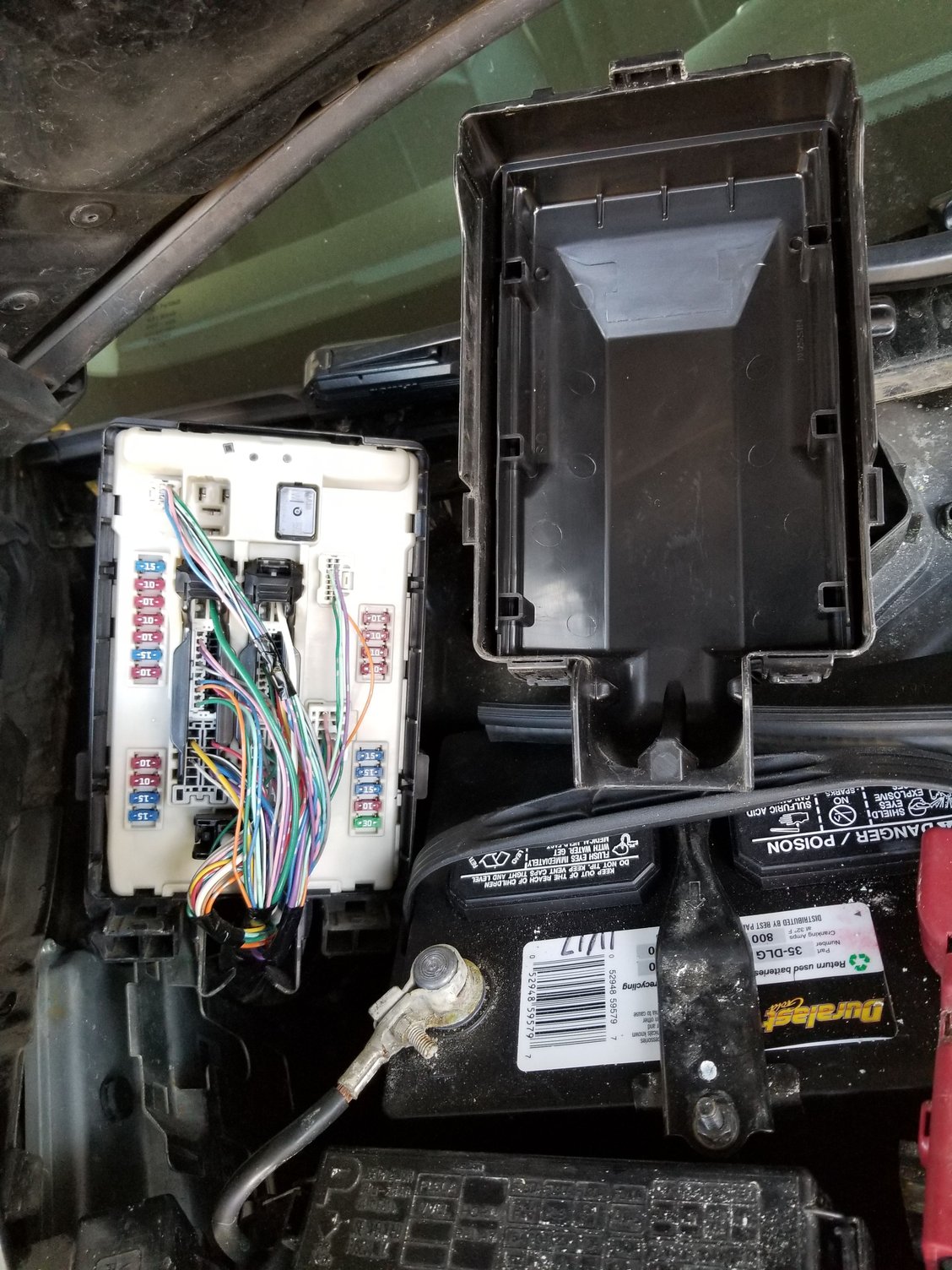

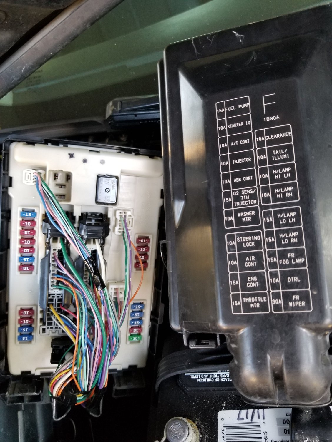

Remove 15 Amp fuse on top left before cleaning to disable fuel pump only

The fuse box can come up above the battery without removing the battery, but you have to push the bundled up cable from below the fuse box or it will feel stuck.
