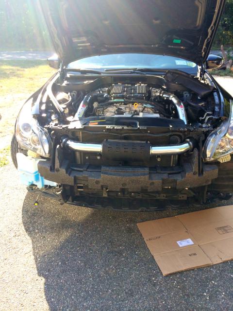

I think what he means is that one of the h-brackets goes on part of the bar that curves a bit.
Note the left h-bracket is attached to part of the bar that's curved.
The following 2 users liked this post by sLADe781:
drkay (02-17-2015), PNW_IPL (05-24-2016)
Old 02-17-2015, 06:47 PM
drkay
drkay's Avatar
Join Date: Jul 2014
Location: Calgary
Posts: 151
Received 44 Likes on 29 Posts
Originally Posted by sLADe781
I think what he means is that one of the h-brackets goes on part of the bar that curves a bit. Note the left h-bracket is attached to part of the bar that's curved.
Thanks for the picture! That's exactly what I meant. Also, I installed the bracket from the intake tube BEHIND the H bracket to gain additional clearance. In the picture above the intake tube bracket is in front of the H bracket.

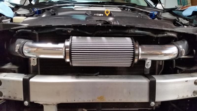

Here's how mines looks. Name:  47C1EBD2-459D-4936-861F-13DB7A30CBC4_zpsvaz4urvv.jpg
