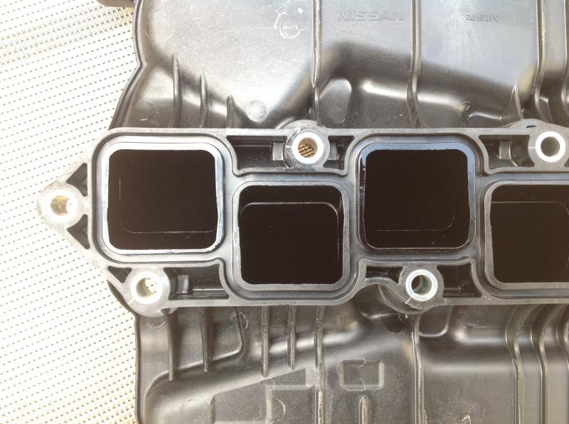

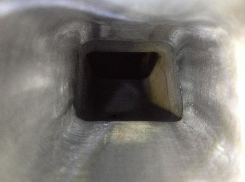

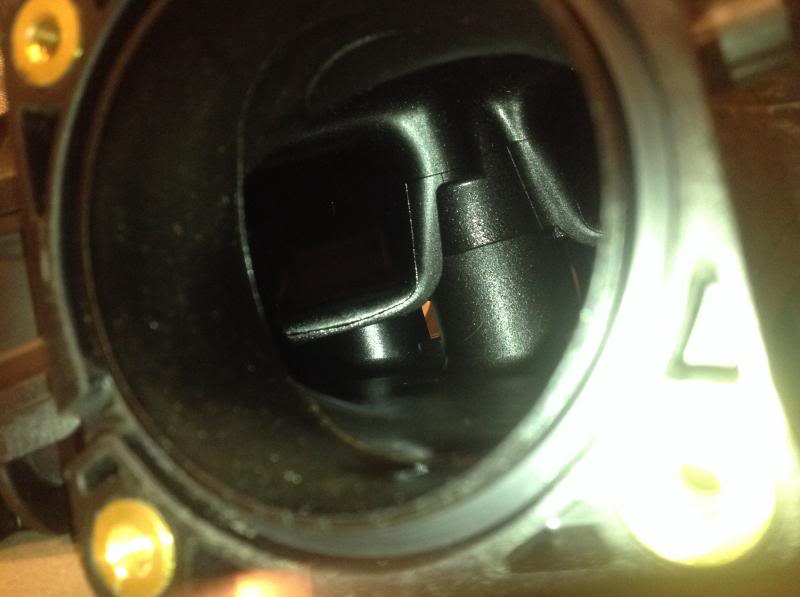

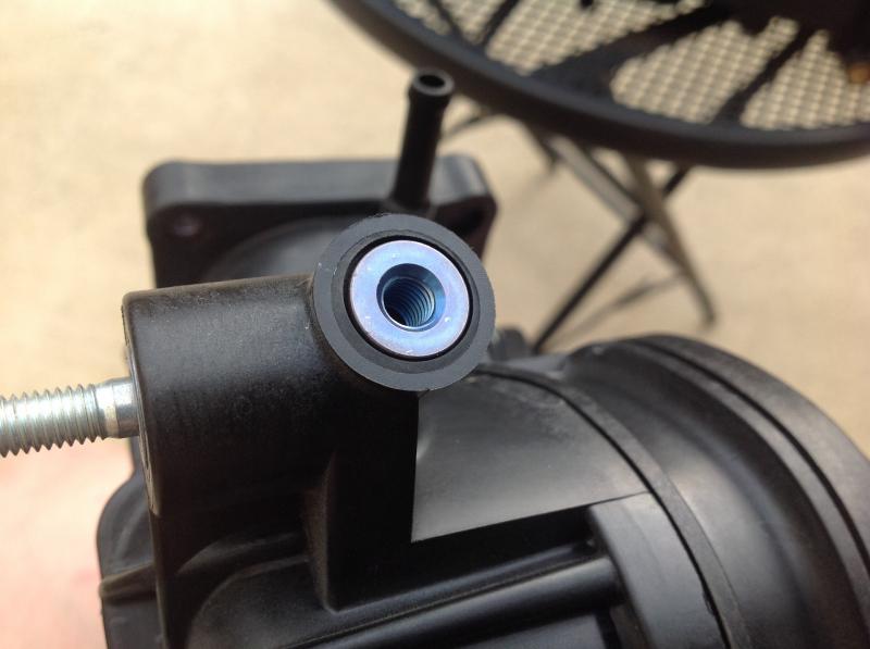

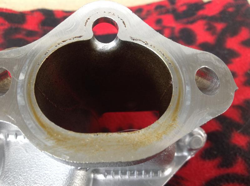

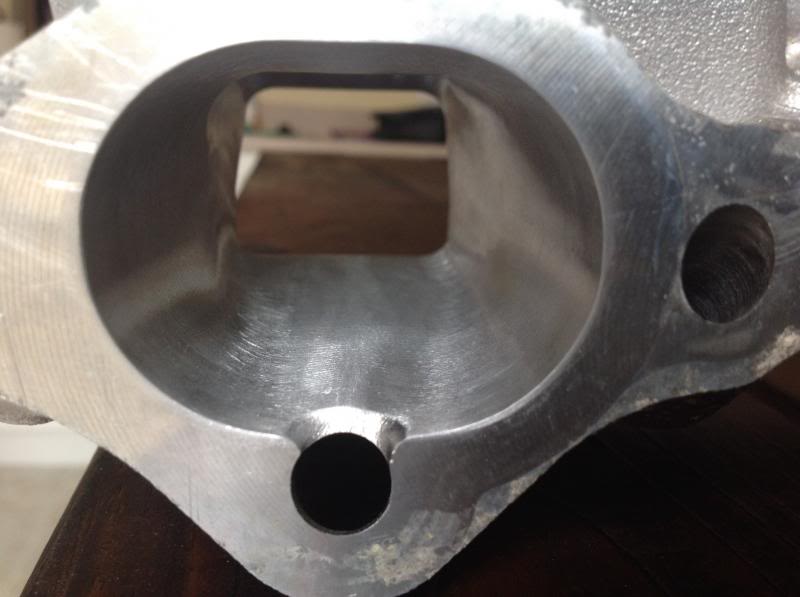

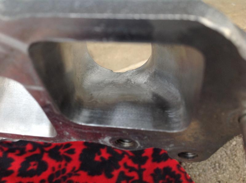

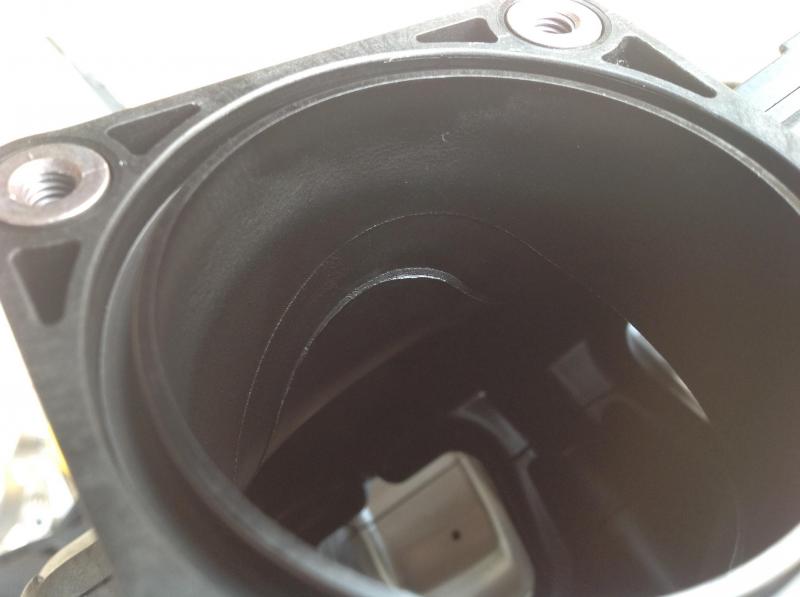

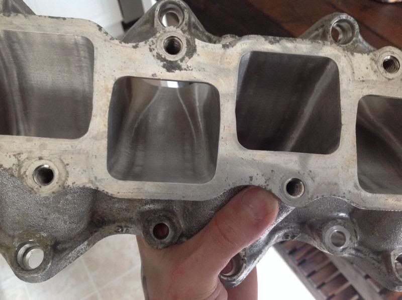

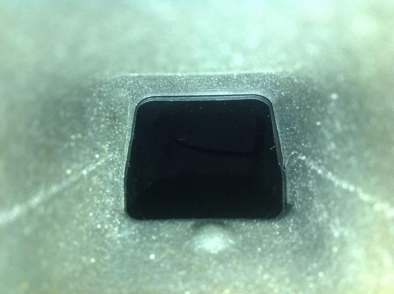

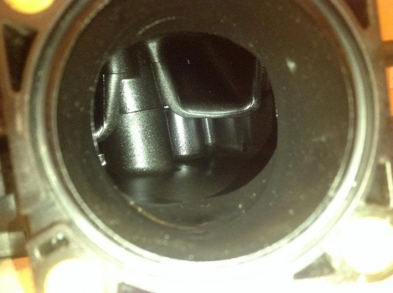

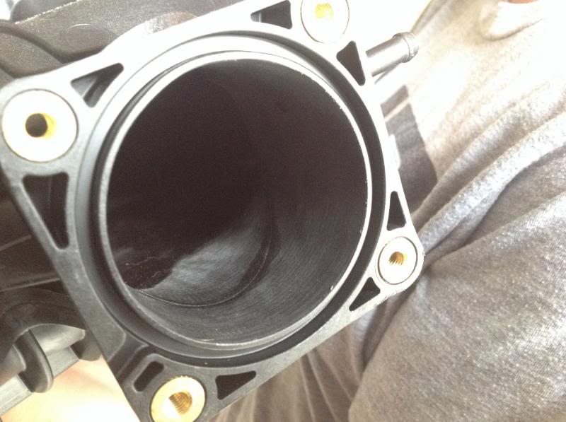

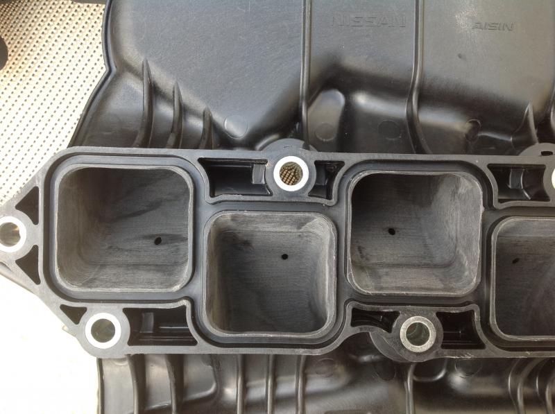

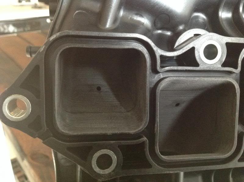

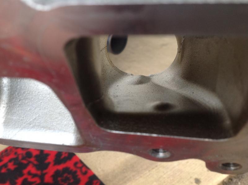

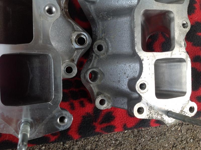

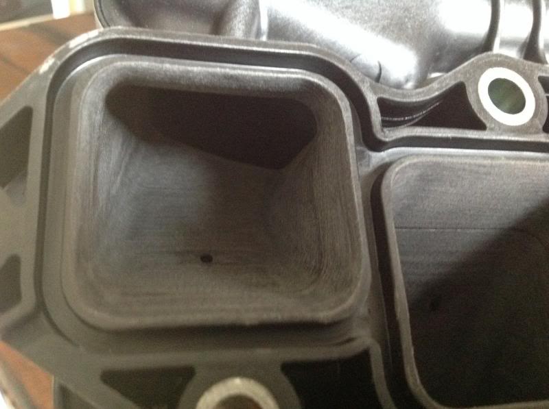

Ok I did the swap last night. Just wanted to show more pics and info regarding the before and after of all the parts side by side.

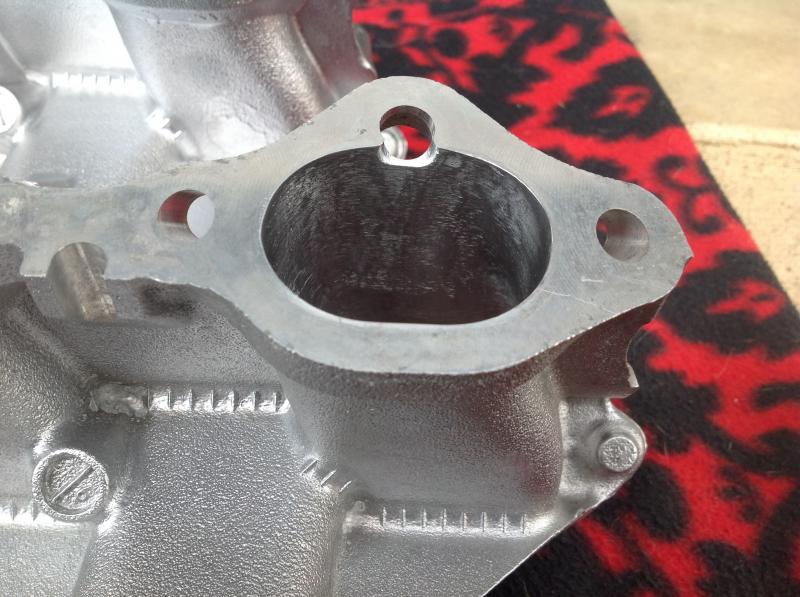

First up the weight of the ported lower vs unported, 5.80lbs vs 6.04lbs. So clearly some weight loss of material.

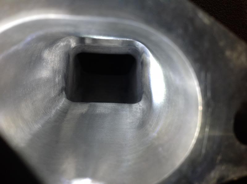

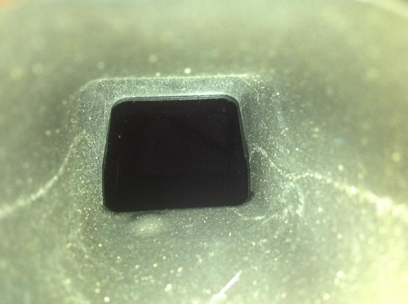

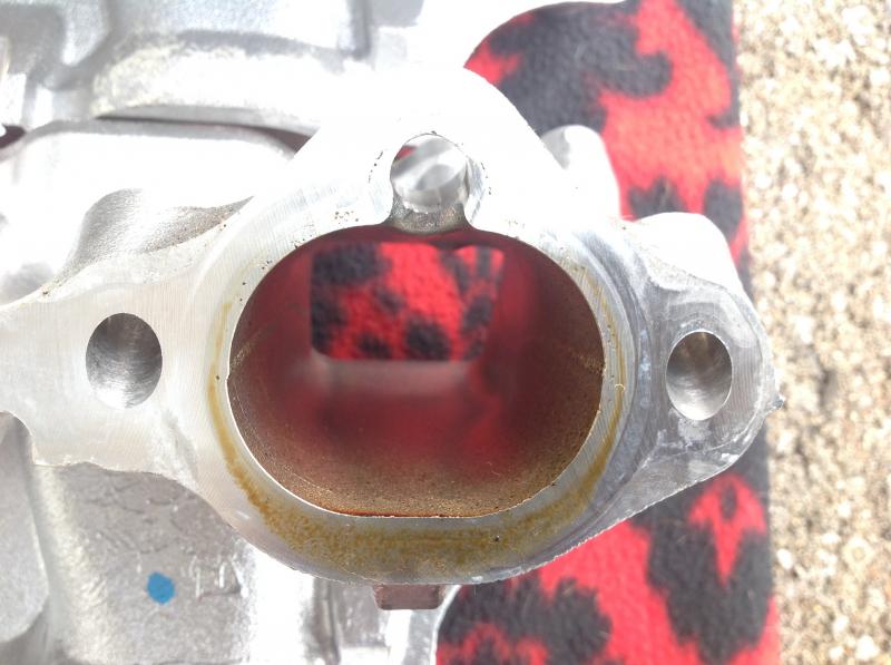

Next, the openings at the bottom of the runners running in both directions, 1.53" vs 1.43" is where the bump is that the injector is slid into. Clearly with the bump gone its opened up quite a bit!! The other way it not as much opened at 1.99" vs 1.98".
Next, the openings at the top of the lower mani are 1.70" vs 1.70" and 1.53" vs 1.52". The reason the upper part didn't open that much (only 0.01") is because every part on the intake system starts smaller at the TB then gets bigger for the next item. This is because nissan wants the parts to never have to "hit a lip" with air flow. It's better for flow to go through a small space and open into a larger one, than flowing through a bigger opening then hit a lip of metal of the lower mani and cause a bunch of turbulence. So the lower mani's upper part wasn't touched much because the upper mani is what got ported to be port matched to the lower. And looking at the pics with upper mani's gasket system we couldn't port more of it or we'd of ported into the gasket space destroying the upper mani.

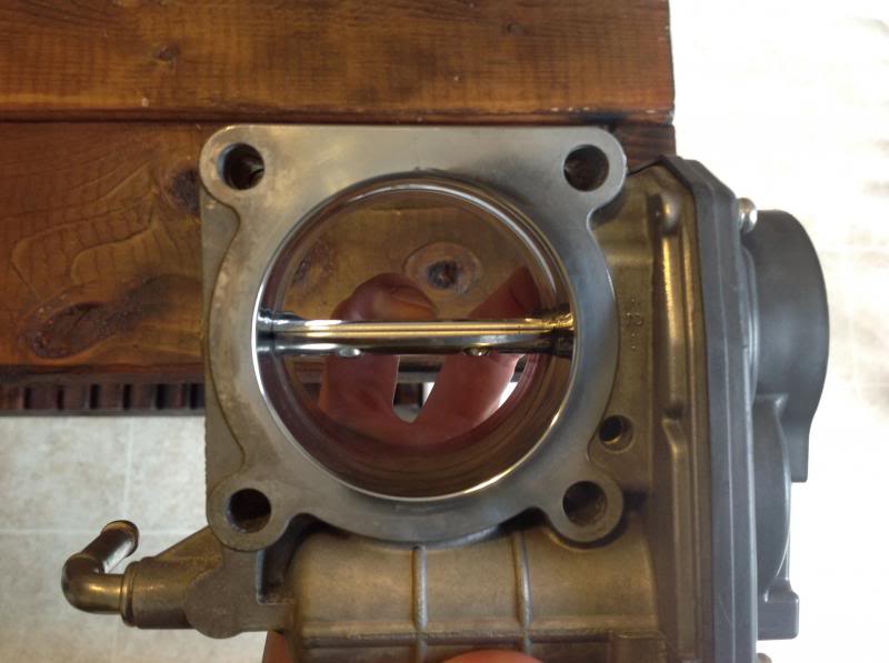

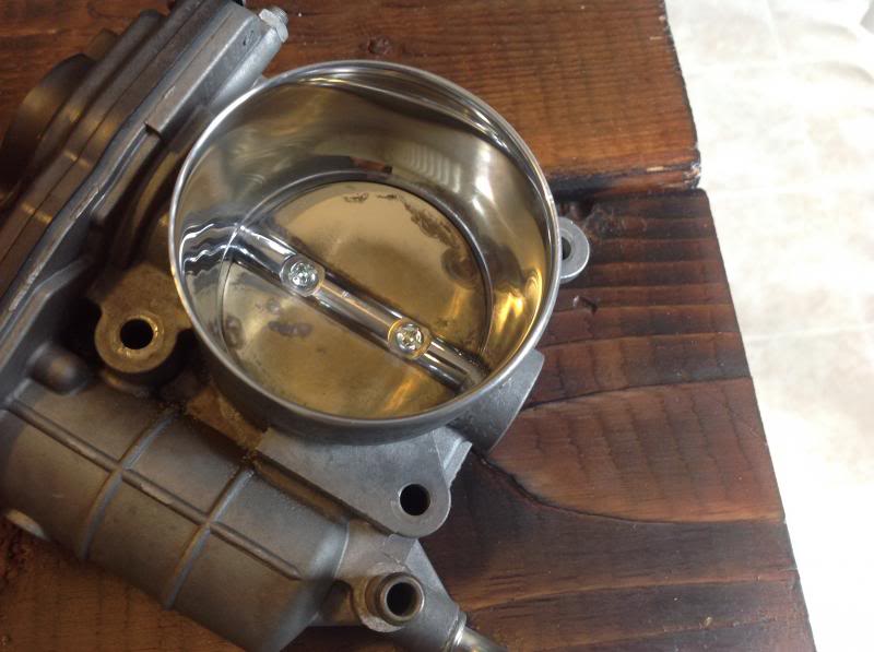

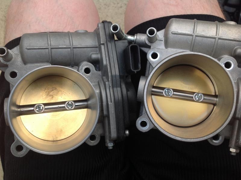

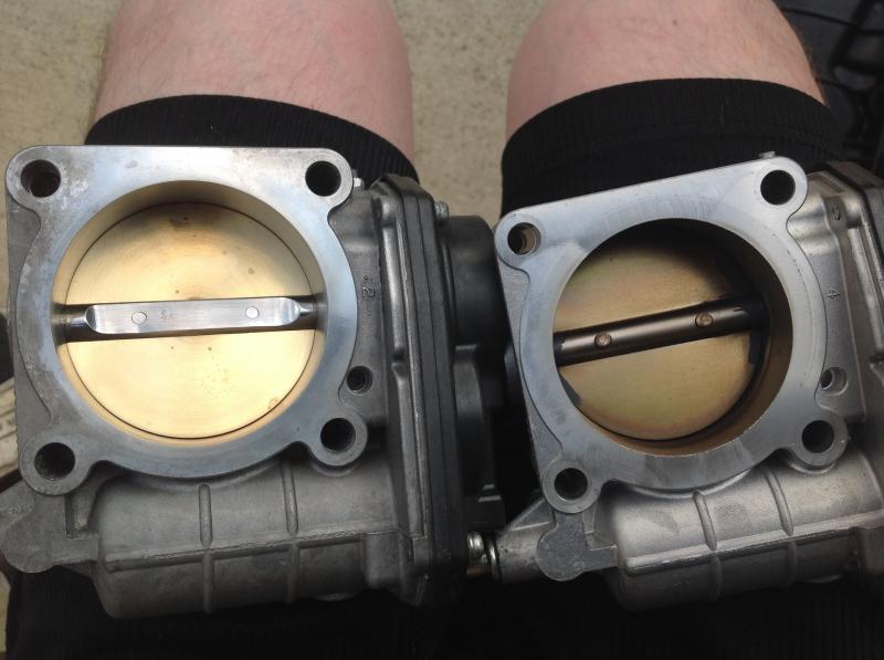

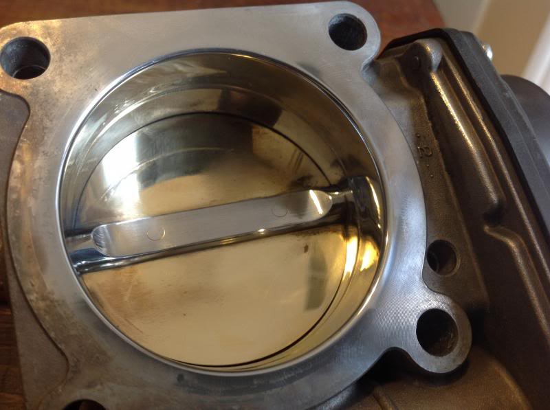

Next, 1.86lbs vs 1.92lbs of each TB.

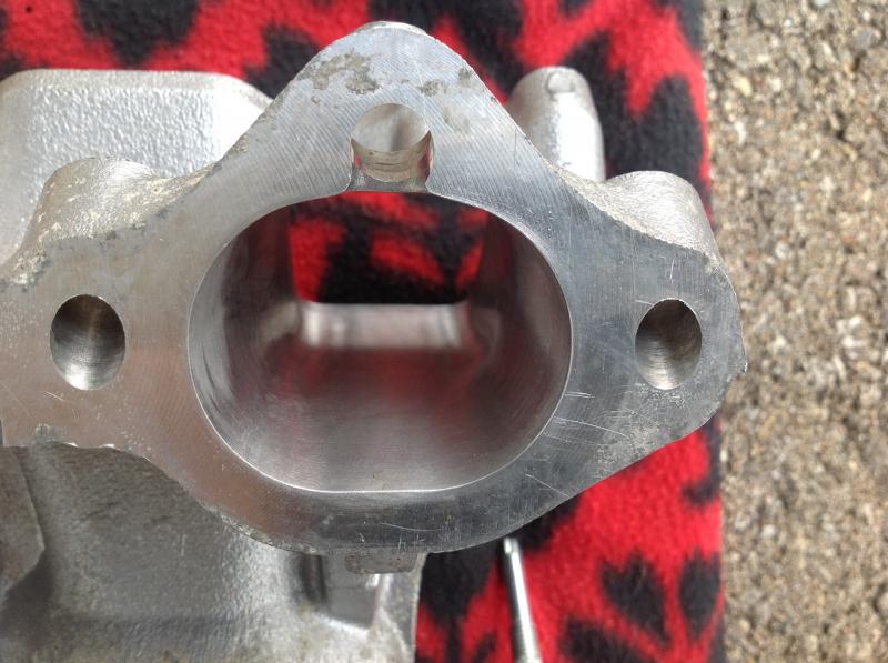

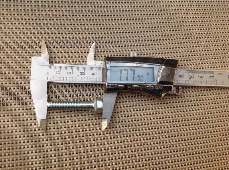

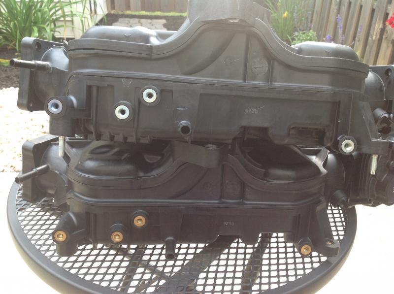

Next, upper mani's weight, 7.90lbs vs 7.16lbs. Now why is the ported mani heavier than the unported? Well the ported one is off a g37. They for some reason give it very long cylinders where the bolts go through adding mass and needing longer bolts. They also use brass vs what looks like titanium on my 13 mani!! All my silver looking threaded parts are rainbow colored like when titanium heats up.
Next, the upper mani runners going in both directions, 1.85" vs 1.82" and 1.56" vs 1.50". Now you'll ask yourself these numbers don't match the numbers above for where it bolts to the lower mani's openings. That's because I didn't measure the exact opening of each item. I stuck my calipers down inside so they laid flat on the parts surface and measured wherever the tips made contact. This just insured a proper measure of each item. The calipers tips are like a 0.5" long so its inside more but i looked and each part is flow matched 100%. You can also see some horrible lips on the unported mani that needed to go away.

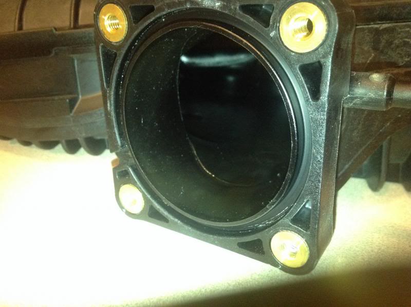

Last, the opening of the TB hole on the mani. 2.47" vs 2.46". Again, because of flow its the TB that got all the porting and not the item it sits on. The TB is 100% port matched now to the upper mani.

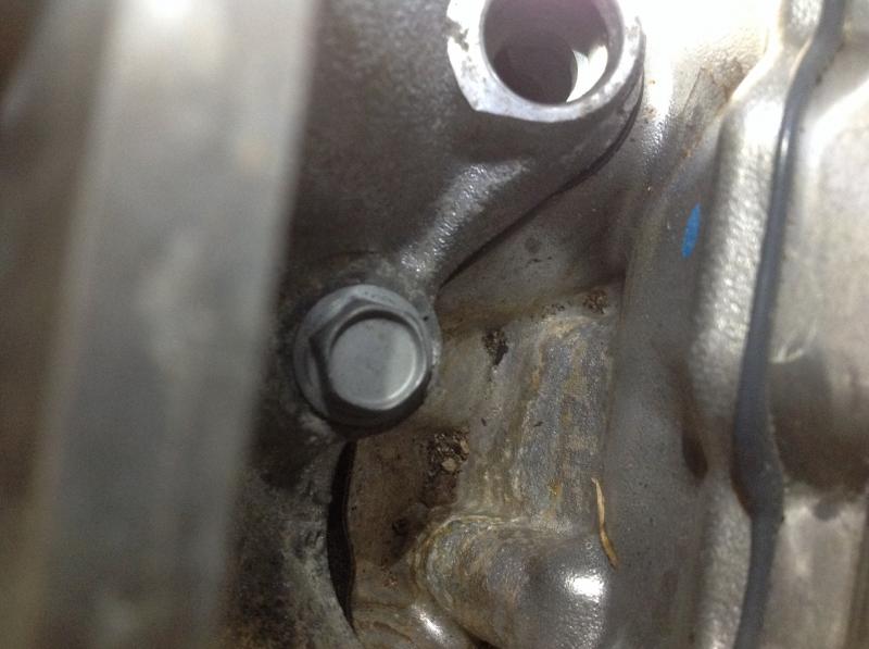

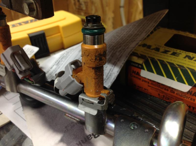

On a side note. One thing I hate is the oil in the system! I'm not even boosted and oil comes out of the gaskets of the lower mani to head and injector o-rings. Just nasty stuff. I need to have my catch can running to atmos.
