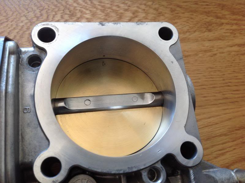

Decided to ship the Tb's to Maxbore instead of just a polish and profiling of the butterfly shaft that I got. I already have $130 into them but again I thought I was getting porting too!!
Maxbore charges $35 for profiling the butterfly shaft which I believe is for only 1 TB so I'm thinking positively on this and only looking at it as a $70 loss instead of a $130 loss since my shaft is smooth
We'll see what they look like when they come back. Again right now the TB is 2.6" at the front lip and tapers to 2.35" at the butterfly plate. Then it goes back up to 2.39" at the back. This is all bad since the manifold is 2.5" so the TB needs to be at least 2.5" also!
I emailed Maxbore and he said these would go from 60mm to 65mm the whole way through with a new bigger butterfly. Hope it all works out this time!

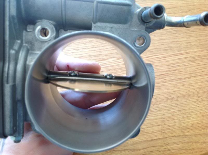

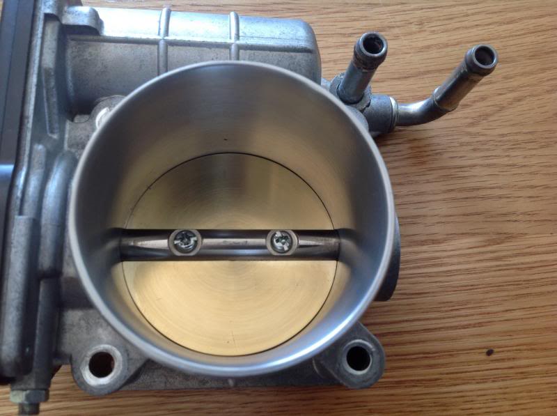

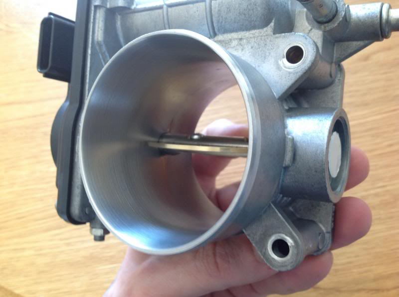

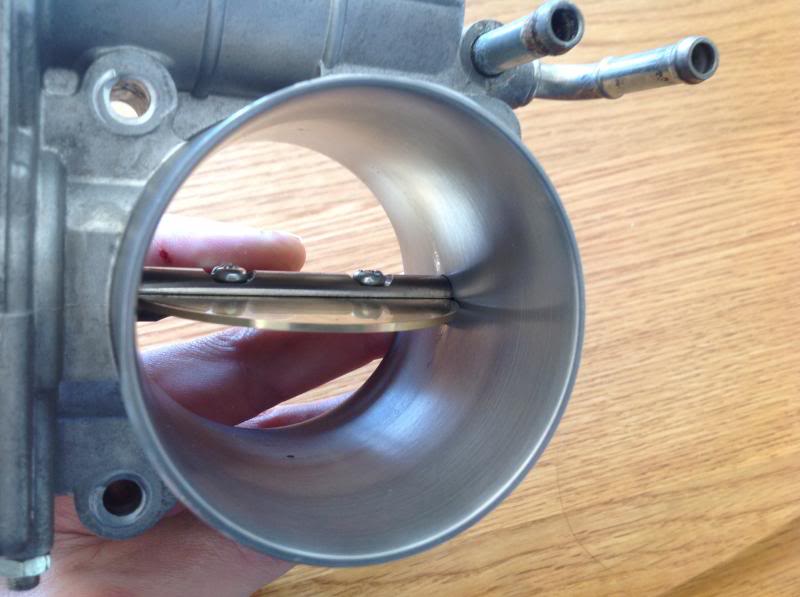

Ok TB's are in.
So front lips gone to 2.64" and tapers down into the center but now there's no more lip. The middle went to 2.51" as far as my calipers can get in from the front. 2.49" now on the back lip which now looks port matched to the manifold!!!! I might have a little sanding to do on the mani, won't know till I bolt them up. And as far as I can get in on the back side closest to the butterfly, it's now 2.48"!
So before 2.6 to 2.5 but then 2.5 down to 2.35 at the butterfly, then back up to only 2.39 at the mani.
Now 2.64 to 2.51 but only down to 2.48 at the butterfly, then to 2.49 at the mani.
I wish the new butterfly was knife edged though.

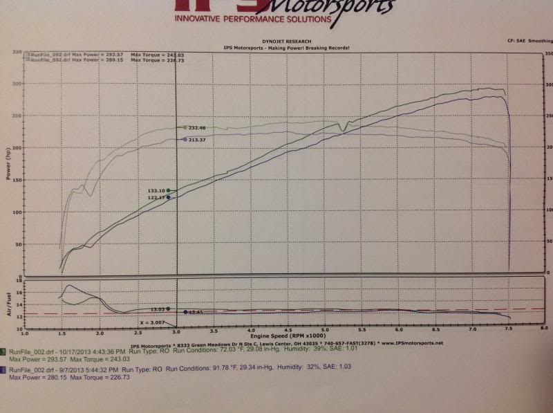

talked to my tuner today. looks like next saturday will be the tune as of right now. however since the porter gave me issue and money here and there i just told him to do a regular old tune and dyno. ill show up with the parts already installed and just go from there. since ill control the dyno settings ill make sure my runs are the same settings and such as in september 2013, august 2013, and next saturday. with a dynojet and the same correction factor, the correction numbers should all give the same numbers as if all runs were done on the say day even though weather changes. for reference ill post the first 2 dynos ive done there so you can see where the car was at in the very beginning, middle and end. wish me luck i get in, get tuned, and come out ahead!
blue line
18x10.5+15 RPF1 with 285/35/18 htr Z3
topspeed true dual cbe with 18" resonators installed
custom cai
green line
custom straight pipe true dual cbe with 18" and helmholtz resonators
custom cai
z1 post maf tubes
ebay LTH
