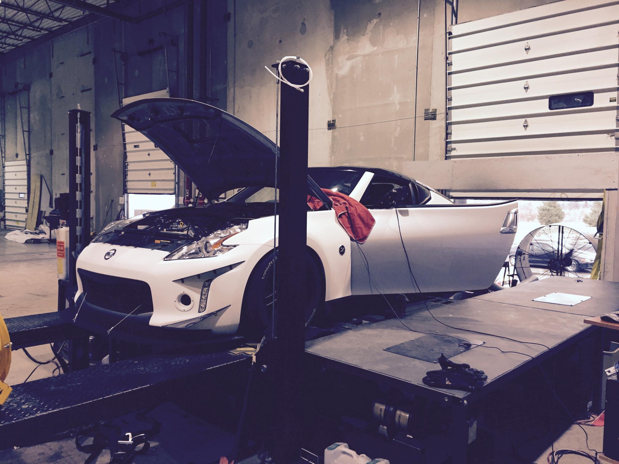

Here we go

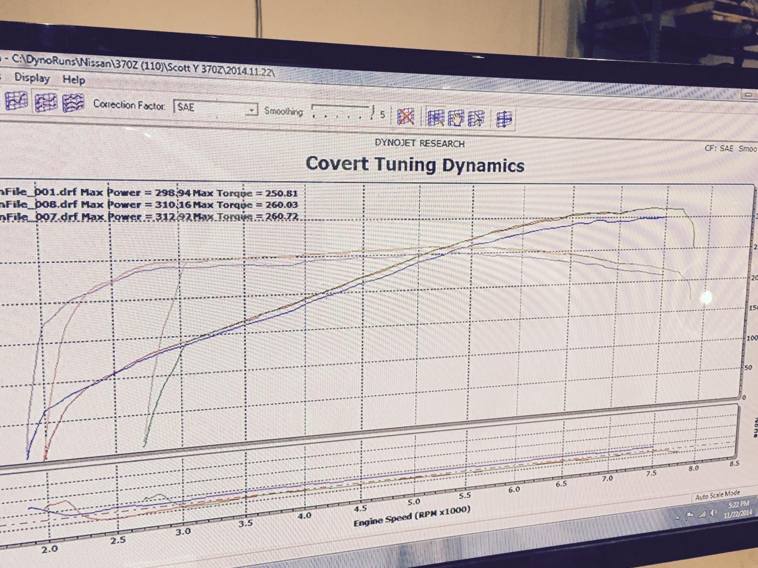

And so far we found why the last dyno was so low and the car made no HP with the porting...the cars knocking and is in a lower "safe" map. For whatever reason target AFR was 12.8 but running 13.5 with a lot more timing then he normally runs. We are adding fuel and having another run.

Gained 14 hp and 10 Tq over other tuner. It was targeting 12.8 AFR but hitting 13.5. So we got it to 12.4 and pulled about 4 degrees of timing as it was to much and knocking and running on the safe mode map. I still need more so e85 is next!

That was on what octane?

93......

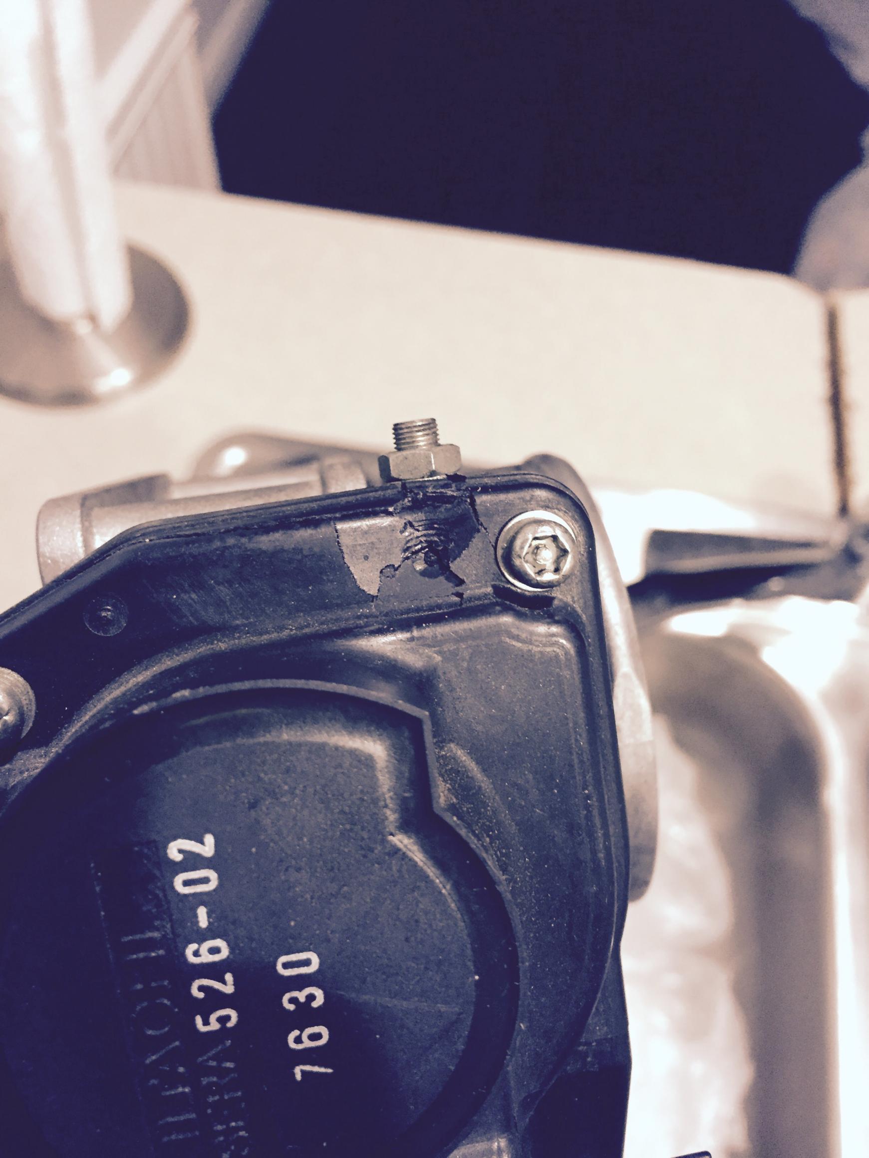

Just a reminder!! PLEASE when you guys ship back your cores protect the parts and apply insurance on the item for the amount I'm giving you back! Does no good to only take the free $50 insurance when I'm giving back $190 or $200 or $250 and the parts destroyed. I just received this TB and there's no way I can resell this! Again I state in the FS thread it's your responsibility to package correctly and put insurance on the returns.
Thanks

Sorry on vacation hunting. Wife just sent pics.
Car made what I thought but we are going to retest next week because the car had cats and we believe its holding us back with not letting out new air in get out.
11hp 9tq down low, nothing mid range and 6hp 5tq up top. With the cats removed we are hoping for 10/10 from start to finish.
