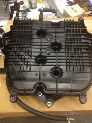

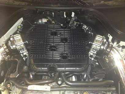

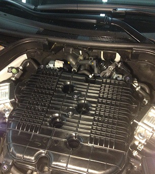

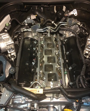

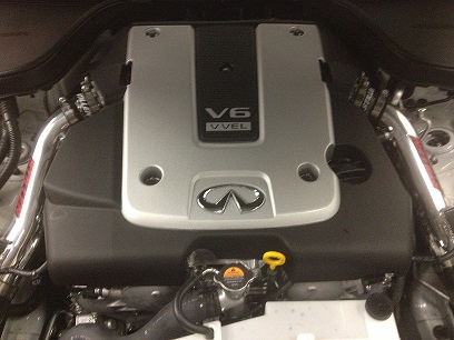

Well the 370 came today and we installed it tonight, best upgrade, this is one upgrade that you can feel the difference right at the take off and through out all the gears.
A couple of small issues with the mounting, sensor port doesn't mount the same way as stock,,
Air intake tube doesn't mount up anymore,, and for over 500 bucks they could have added some sort of mounting bracket...
One last issue, there are a total of 8 mounting bolts overall , the 2 in the back and 2 in the front mount up fine, but the 4 inside bolt are a little bit of a problem, they do not mount up exactly correct, so what they did to compensate that the was milled out a small notch so the bolts could catch, and that is why they supply the top plate, but on the one I received only 3 bolts fit and one did not.
I spoke to the tech over there Tony and we decided to finish the install only using 3 of the center bolts instead of the 4 that are required, but until we get this straighten out, I guess this will have to work
All and all great upgrade,,
So to make a long story short out the 3 mods we did this week and believe me none were straight forward they all had issues none were as easy as the state.
The M370 is the best by far for feeling more power
