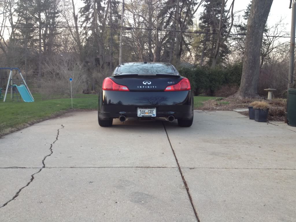

It's all installed and fits great. The guys at the exhaust shop were drooling over the fit and build quality.
It doesn't hang too low so there's no worries if your dropped like I now am! You actually have get down on your knees to see all the piping from the back so it doesn't look all riced out.
You can feel it pull harder on the bottom end and top end rpms.
The sound is obviously louder than when I had the axleback alone but I wouldn't say it's obnoxious. You feel and hear more inside the cabin. You can creep around silently but once you hit 3k rpm watch out.
It's still one of the purest and most distinct exhaust notes. Not high pitched like a inline 4 cyl and not gurgling like a big V8. I'd describe it as more exotic and clean like the S4 or S5.
