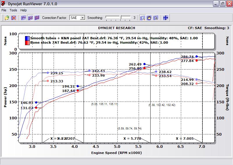

Very solid post Lego, amen. I too am running AFE dry flow's + Z1 maf tubes + no hood liner :-) I haven't seen that dyno chart before, but those are some pretty solid gains. I've also read on the 370z forums a lot of folks rave about a simple drop-in and tube combo with good reliable results.

Thanks. Those gains seem to be inline with what others on the 370 board are getting, which is easily on par with SRI/WAI intakes.
