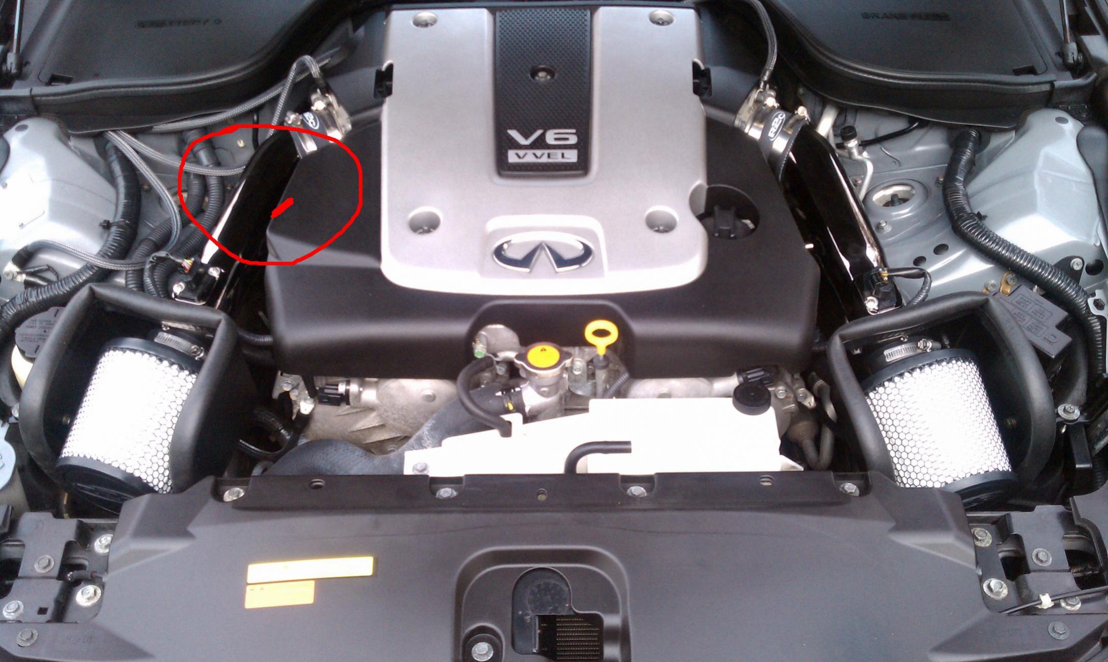

Back to my question. I installed the right side (drivers) in under 20 mins without any issues and the fitment was perfect. The problem i had was on the left Passenger side intake. The r2c requires you to remove the intake and the the stock loop around hose. They supply a straight hose that you attach to the engine and to the intake itself. The problem i keep having is when the intake is installed that hose has to make a 90 degree turn so it ends up bending and stays almost closed. Is this terribly bad for my engine and have you guys found any workarounds for this issue?

I went to the auto parts store and bought more hose that I could cut to length.

What he said.
Back when I had one.
I went to an Autozone, and found they had breather hoses in the back.
Pick one with the right bend.
I got one that was too long on the straight side, which helped, as I could cut it down perfectly.
